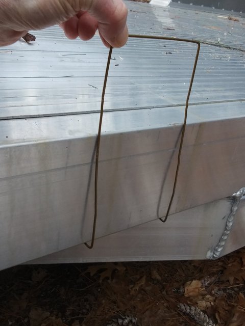

This trailer only has 4 anchor points, one at each corner. I like the side wheel net/losso but I have nothing to attach to.
Does anyone know if someone makes a hook that can catch the trailer frame? Here is a mock-up with a coat hanger. It would be great to have something like this in 1/2" alloy steel. I can make something, but if anyone has seen anything like this please let me know, thanks!

I would put bolt-on D-rings on the frame rail instead, with a decent size backing plate.
Ideally close to a crossmember.

That is my fall back option.

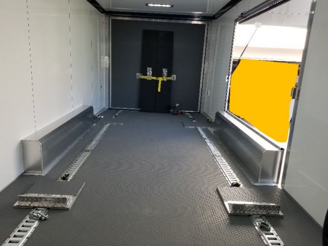

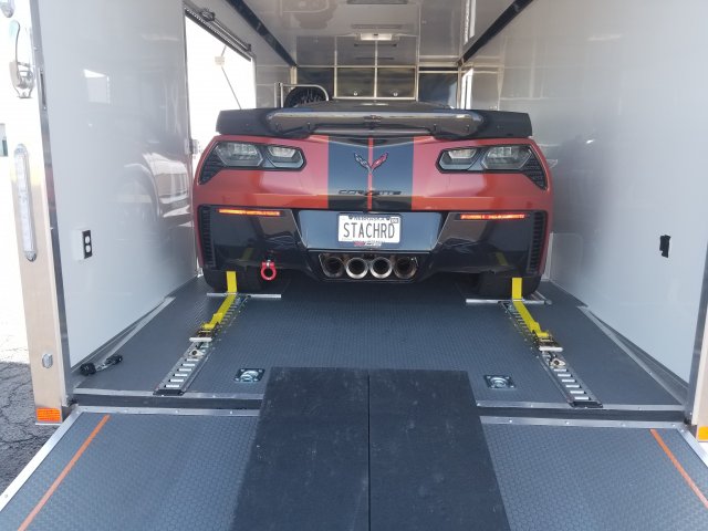

I have an enclosed 24' trailer and use tire nets to secure it to e-trac. I'm not to keen on anchoring the car frame to the trailer, that is hard on the suspension. The open trailer makes for easy loading and tying down. @DGatzby has a great way to to transport his RE on his open trailer with the tire nets setup. But while I was coming back from Road America last year I was caught in a hail storm in Iowa and strong gusty winds and ended up with $30k worth of damage to the trailer and truck. But the car didn't suffer any damage though. The car didn't move around one bit.
