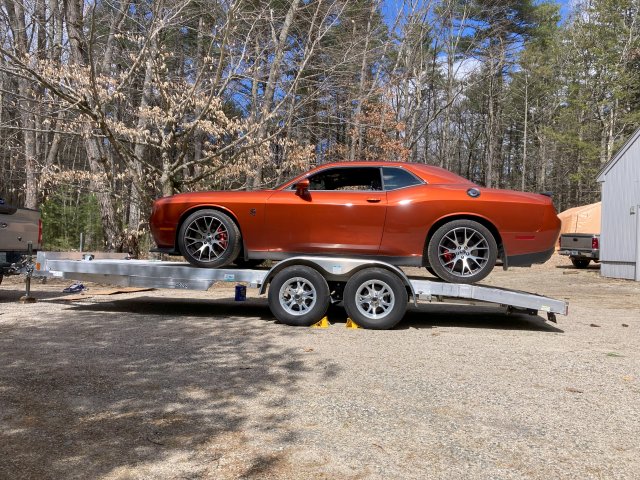

It appears that David has a very good eye. The original pic did have the car too far forward. I was checking straps today and positioned the car for 10% tongue weight and it looks al lot like the pics you guys posted. This is why I ask you guys for help, you seem to really know your chit! Thanks again! (Yeah, I know it's not level in the pics, it's on the jack. I did have to change the ball mount to one with more drop.) IMG_0051.jpeg

I want a hitch with a tongue weight gauge. That way you can adjust the load as needed.

You'll never be wrong with a weight safe hitch and a set of air springs in the truck.
They're great hitches.
6,284
11,769
But they cost more than a real tongue weight scale, I think, which is more accurate.
