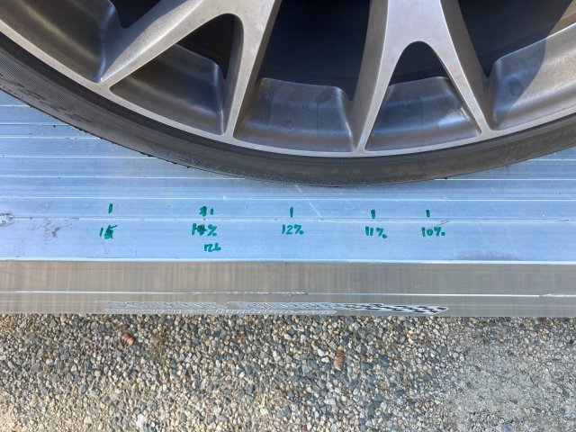

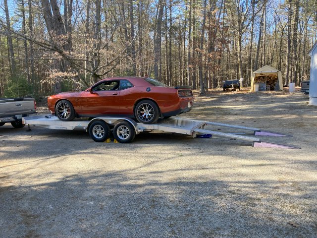

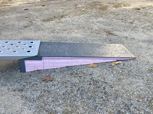

Spring FINALLY has arrived and I was able to set up the trailer. First was testing the custom race ramps I made, they work perfectly!
Next was figuring tongue weight, I set up a beam with pieces of steel angle to act as knife edges to put 1:3 on a bathroom scale. Then calculated tongue weight % based on car location and marked it. Now I have a reference so if anything funny happens at speed, I can adjust and know where from and where to.

Nice!
Go a bit heavy on the tongue if you want...it's a whole lot better than not enough.
Nice!
I like mine more balanced over the axles. Gives me a more stable and comfortable ride.

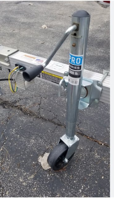

It's sitting on the jack.
Not sure I understand. I'm old, simple is best! :)
Balance without it sitting on the front jack. You can then tell how it's really balanced.
You don't want the ass end dragging.

Sorry, still confused. The jack was not involved in my measurements.

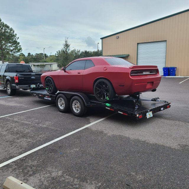

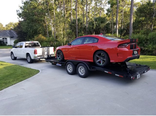

F150, 24ft. Look at position of car.
Same trailer. Different car and truck. Look where the rear wheels are.
6,778
12,615
That's also a heavier trailer, putting more weight on the tongue even when empty.
I agree.
Did he balance with the jack down or up?
If down he might need to move it back some since it's moved up on the axles.
