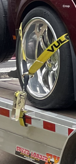

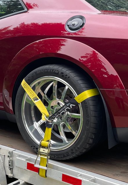

I was thinking maybe 4 straps on the back, 2 straight and 2 cross, retaining the rear is 90% of the game (I think). The front is just to make sure it doesn't roll off the back or fall to the side in an emergency/collision.
I completely agree with that the rear tie-downs can be the most important, but four...
The two that would be crossed is a no-no in the first place, and if at about 45 degrees their strength/efficiency is cut in half even if the abrasion between them hasn't lowered their WLL. And that's not even considering the physical clearance for them. Would work better if it was your pickup on the trailer.
Two straps at a slight angle outward from the wheels will provide nearly full strength in a frontal collision scenario, yet keep the Challenger in place laterally.

#74
Agree. Except that I'd use the far more substantial stake pockets instead of the rub rail.
Why? The car is positioned for the center of its mass to be where I want it. Jimmy for the experience you have, I am surprised you are telling me to position the car with respect to some minor shit on the trailer as opposed to getting it in the correct load point on that trailer. Show me structural calculations where tying it where it is positioned is not adequate on that rail. Show your work and I will be interested in vertical vectors please.

#76
In your case, if the car is positioned correctly for tongue weight, I'd run the lasso strap to a stake pocket D-ring in the stake pocket just behind the center of the tire.
I have never run four lasso straps straight down vertically, wanting more fore and aft efficiency. And why the stake pocket D-rings? Because I only use hooks with clips, not wanting anything to possibly be able to detach.

Thread Starter #80
Thanks. I did a bunch or research and this was a popular setup, but my immediate reaction is the pulling down and to the side does almost nothing for F-R support. In hard braking I would expect the car to shift forward until the strap is at sufficient angle to provide rearward support. I was thinking maybe using this system and adding another strap from the D ring to the trailer rear tie down point.
