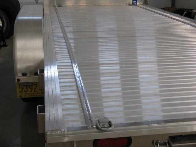

I put L-track on mine so I could use wheel nets and/or wheel straps. I'm one of those that refuse to tie to unsprung weight.

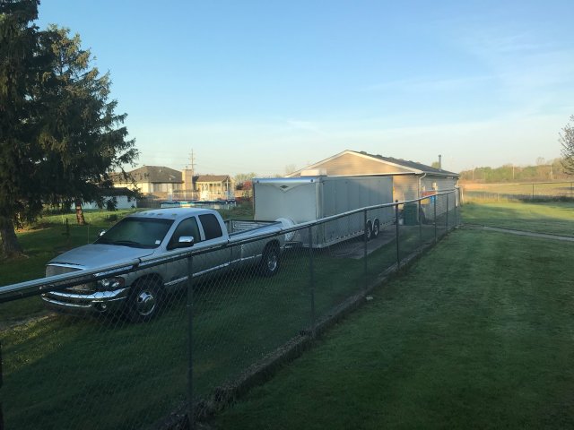

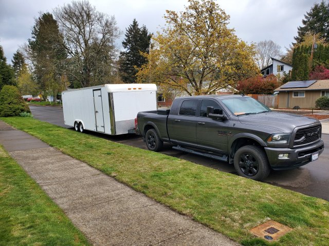

Towed 1000’s of miles, it runs down the road just great with that heavy car etc.
This is my 6th trailer. This has 2-7500lb axles. 14 years old, and the spare has never seen the ground. It's been everywhere, and on it's 2nd set of tires... due to age-cracking sidewalls.

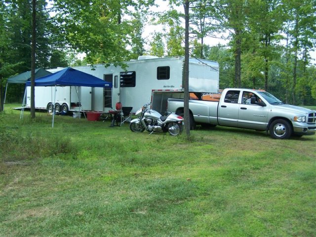

This was ungainly, but served it's purpose when I ran Nostalgia Pro-Stock.

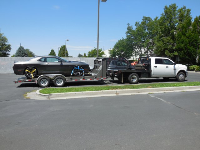

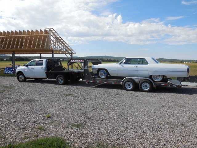

I've transported all kinds of vehicles on my 18-foot trailer, but recently decided to look into getting a 20-footer.
Well, they don't seem to make this kind anymore, so I'll either add a foot or two to this one, or simply leave well enough alone. DSCN2112.JPG DSCN2124.JPG

Yeah, that's partially what made my think about a longer one. But if you look at the Challenger on the trailer you'll see that it could've been moved forward by over a foot.
Of course, my unfair advantage is that by driving fast, the odds of getting rear ended are minimized.
Anyway, at 16.5 feet a Challenger fits fine on an 18-foot trailer. Even a gooseneck where there's a "wall" in the front.

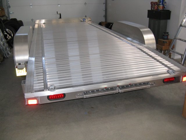

Found a 2021 Rance 20’ 7k alum trailer, weighs 1335# so gross weight would be about 5835#. Light weight is important because I’m towing with a 1/2t.
It will be summer towing only so road salt will not be an issue.
Asking price is $6500. I can get a cheap steel 7k trailer for $4k new, but 700# more weight. I like steel better, but the light weight should be much easier on the 1/2t truck and much more driveable.
I have never trailered a Cat, only boats, horses, dirt and stone, so thoughts and advice would be appreciated.
(BTW: He has a nice garage!)

One other thing to double check is width, between fenders or rails. I believe a wide body Hellcat is 79" and my Featherlite posted above and here is 78-7/8" inside of the raised rails. I didn't buy it for that as that is obviously too tight and if I need to haul it I will have to use my 24' Enclosed Pace as it is 82" between wheel wells which is tight as well.
I'm a NB guy so I think I'm ok. "Interior Width" spec is 80". Besides, the fenders are removable. Thanks for the heads up!

A 10K rated trailer will just beat up your 'Cat, unless it's air ride. 5,200 is ideal I think, but with an aluminum trailer 3,500 will work, just keep an eye on the bearings.
View attachment 126185 View attachment 126186
Funny you should say that. I looked at 2 other mfr's of alum trailers and they both warned me away from their 7k recommending the 10k, maybe their spec was optimistic? I contacted Rance, they the 4500# HC should be fine. They further stated a trailer rated for a load higher than the actual load will cause a more harsh ride for the Cat. Made sense to me, but I'm only an engineer.
