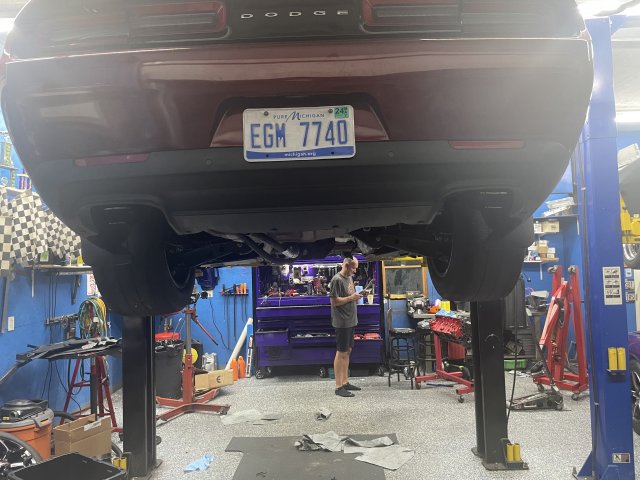

Well first off its upside-down! you Midwest guys really are special! :ROFLMAO:
When you hit the go fast pedal it flips it back over

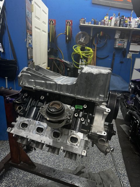

what happened to your engine, what lead you to look inside cyl. I`ve been over the post an confused as to what`s going on. I see oil in valve relief, can`t make out if valve is just open or bent. what are the symptoms?

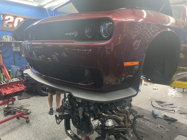

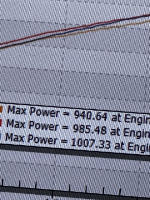

Here it is first start up. Took a week total take out build new 428 and install. Trevor at Manton push rods hooked us up and overnighted all parts AJ sent his secret sauce cam. Making 80 psi of oil pressure running great on Dyno this afternoon.

not bad for a 2.7 blower on 17 psi.
