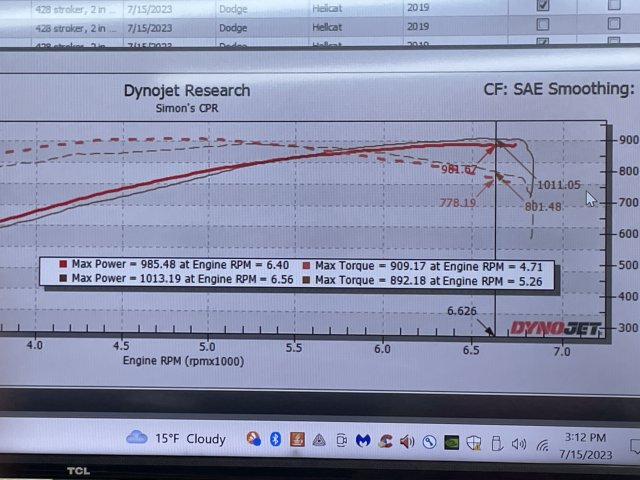

Has to make more than 17psi he has the SDG snout that adds 1-2lbs alone. What pulley? I’m skeptical
He’s a 428 with a cam with overlap that reduces cylinder pressure. Better flowing heads. What do you think the boost should be?

Fake numbers.......
It has to do with the scaling of the numbers to fit everything on the graph.

Should have put LOL after the fake numbers bit.
The reason why the lines don't cross at 5252 like they have too, is because of the way the dyno scales everything to fit on the page. If we could see the left side scale and the right side scale the top line would be different for hp and torque numbers......that is why the lines don't cross at 5252.
jonx96......I know your car and tuning ability is the real deal.....gonna be iteresting how far down in the 8s you get this.
