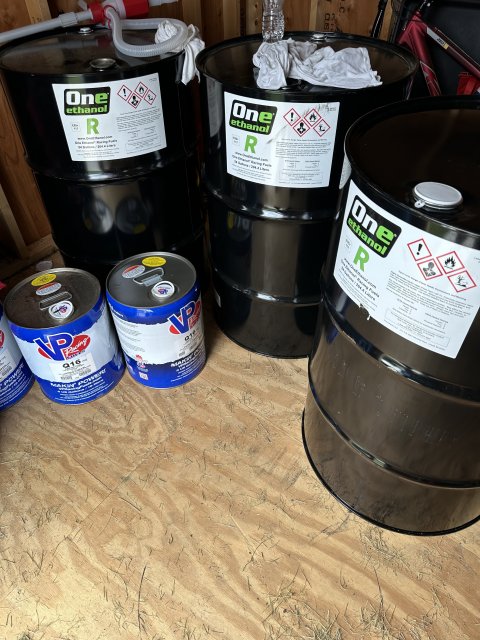

You guys are lucky to have E85 pumps. This is what i have to do it have E available to me. It is over an hour and a half to the closest E 85 pump and you never know what you’re getting from them IMG_6234.jpeg

You guys are lucky to have E85 pumps. This is what i have to do it have E available to me. It is over an hour and a half to the closest E 85 pump and you never know what you’re getting from them View attachment 109997

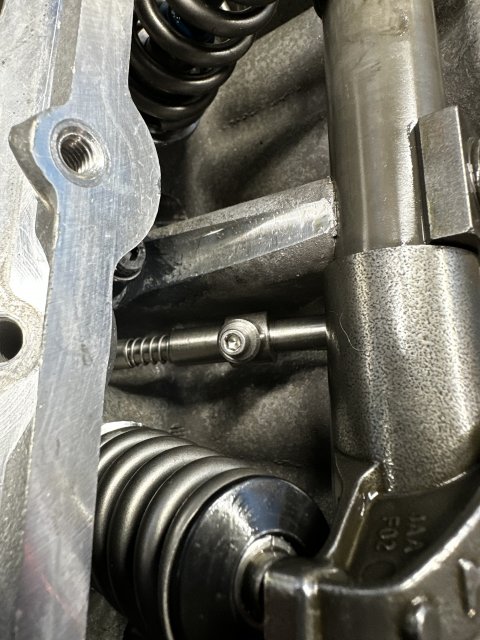

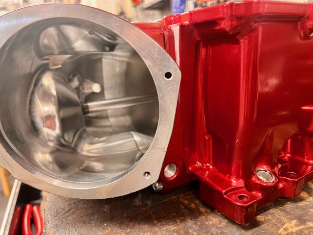

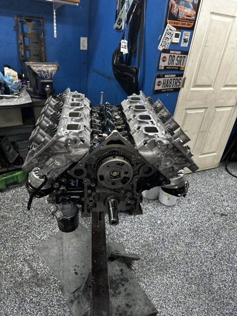

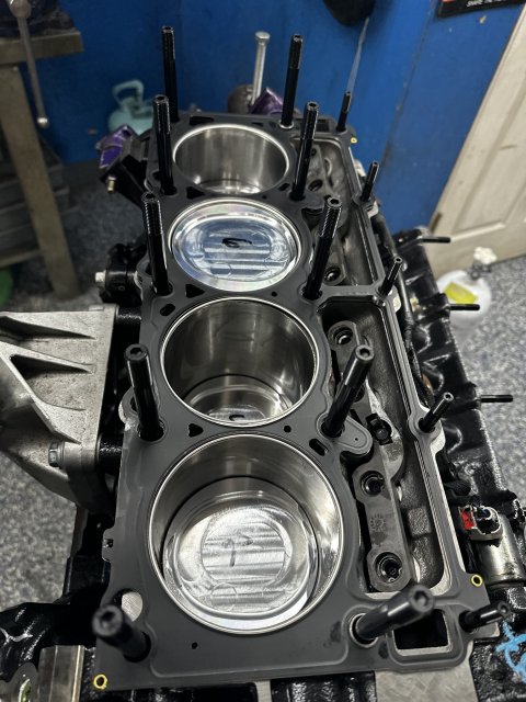

71080641161__D7283DA0-A564-4038-B14B-7E7CC1DD31A3.jpeg 71080344756__11824700-353F-4CD0-92A7-5BCF8F049491.jpeg 71080562001__AE15C48B-15AC-47FD-A317-A65F9D3F82DB.jpeg
should be back on cradle in the next day. Had to have push rods made. Trevor at Manton push rods. Had them made and shipped in hours for us. And hooked up on the cost.
4,385
10,906
Thread Starter #1,394
HP guesses? ;)
