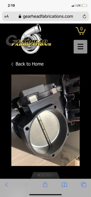

It’s been awhile since an update so here we go.
Car was supposed to be ready last week to pick up. Car is running great but Tommy was doing some street tuning and data logs and the car kept shutting down at high rpm in 4 and 5 gear. We had to cancel our dyno appointment due to this reason. Tim Barth and Tommy were working on the tuning all week last week. Tim saw the issue in the data logs and said it’s the throttle body closing shut at 6400-6500rmp. The VMP 105mm is a great but not for high boosted cars. This ported Magnuson is no joke when it’s at full throttle.
So this is on the way
New GHF 108mm tb. Gear Head was having same issues with multiple throttle body’s including the VMP on there big builds pushing high boost. They said it’s been tested over and over again and will not close up at high rpm.

GH 108mm TB supposed to have stronger internals to help the Tb stay open at max air flow.
We shall put it to the test. View attachment 33005
I’ve got the same throttle body coming in this week for my car.
My whipple throttle body motor finally died after lots of miles and abuse.
What’s cool is with this throttle body I can finally run the 3.0” pulley with my whipple. I’ve only been able to run that pulley twice successfully without it slamming shut and going limp.
Be curious to see how well it holds up.
I trust Mario allot, so I am expecting some good things.
I’m looking forward to get this new throttle body as well. I ordered it 2 months ago and still on back order. It just sucks waiting on car parts.
GHF has been great with communication and customer service. The company that is making the stronger internals and motor for this TB is on back order as well. Hopefully some good news next week.
Talked to a few people that has the GHF 108mm Tb on there cars and so far so good and no issues. I’m really excited to get it.
