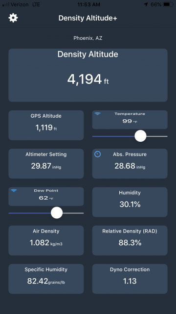

As much as I would like to spill the beans, I’ll have to let James share his news. I’ll just say this.... when you get up and check the weather at 5:30 am and it’s 91 degrees...... you know it’s less than perfect for doing this. But it’s Phoenix in July. Dyno room was 110*, the DA was 4200’ and Maggie was singing like a fat lady. 😂.

Alright let’s start out with the weather. It was awful lol. Now the temp says 99 outside but in the shop on the dyno was 110 degrees. I swear that’s my lucky number. Last year same time with stock blower it was 110 degrees.🙄😂😬
