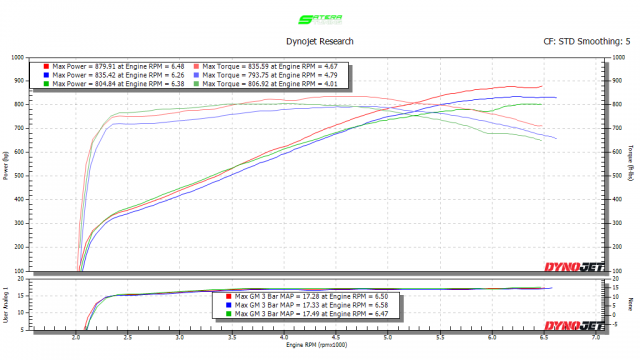

Jeremy who owns Sateratuning did a killer job. If you read my last post, you knew about me having a mechanical issue and deciding to shore up some stuff while I was there. Brought it back today. Car drives great. Will be going back to dial in the nitrous tune next month most likely. My old setup made this power on 3lbs more boost. The headers and cam brought down the boost. We are shifting this at 6700+ due to the motor being able to handle it. Last time out at the track I was only seeing 6200 shifts. I look forward to letting it rip. Jeremy is a great shop owner and an excellent tuner. His customer service is there and actually answers questions when you have them. The car also runs on his new flex fuel setup. The graph you see has 3 pulls, e85 top, e70 middle, and e55 bottom. Car adjusts timing on the fly. I can run 93 if I want on this setup, but with my little pulley I won't go WOT on it. We "probably" could do it with the car being very conservative on boost compared to where it was, but the power is made with the corn.

75 horse difference with E85 is pretty crazy. I also would have expected more from E55. I was under the impression the difference in E50 and E85 wasn't all that much octane wise. Nice comparison!
Depends on how aggressive the timing is on the E85. Could be a very conservative tune on E55 also.
I'm sure the timing is fairly low on the e50, I agree with your impression and e50 is pretty close to 100 octane I believe. The "best" timing comes in though when the ethanol is better.

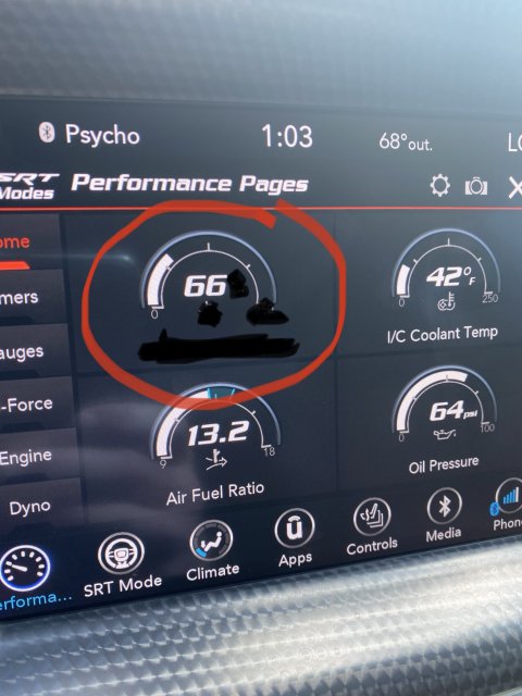

Another cool feature is onboard ethanol content....
What is that input normally supposed to show since its blacked out? Lol.
I figured he had to hijack something to make it work.
20,157
#99
Straight ethanol percentage by volume?
IAT
