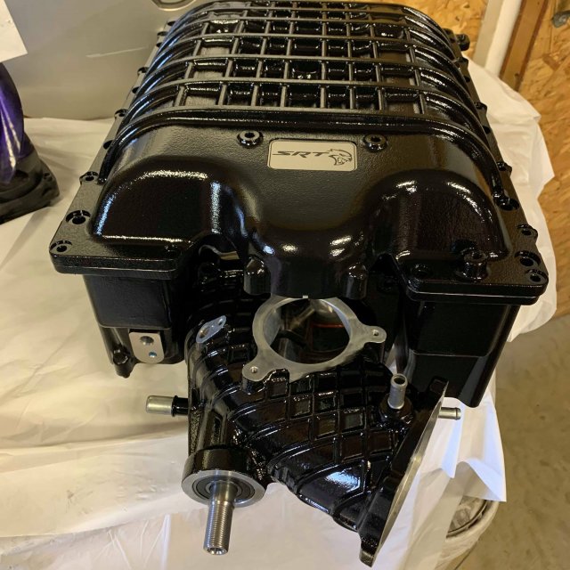

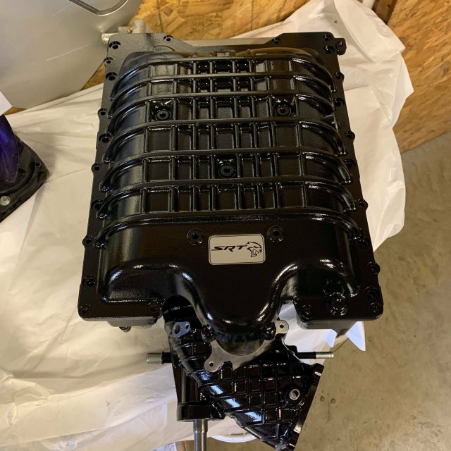

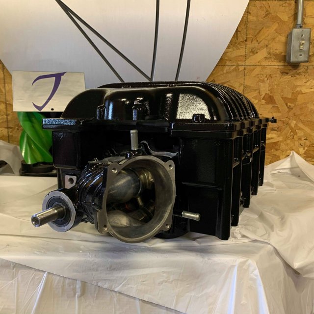

Update:
I had plans to install a bearing plate and do an apples to apples comparison, but after some drama which made me uneasy, I sourced a spare blower off eBay and sent it to Jokerz for his full race build.
I’m curious to see what it will do plug and play. It’s come out that most of the restriction in the blower is the bearing plate. I currently have a hand ported snout with a 105tb. Only change will be the new cnc snout, bearing plate, and blower.
Stay tooned

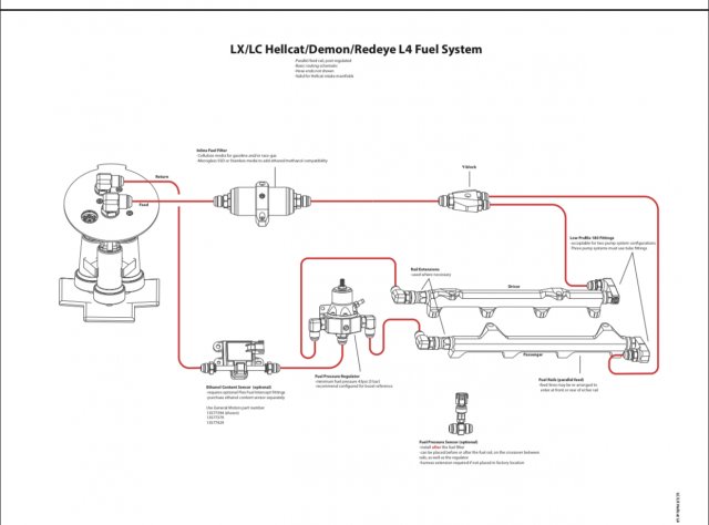

Soon...having my fuel system done while it’s there to be done with it “forever”
E7F8DC43-7761-4B5F-966C-5D53265EA484.jpeg 3C6D461D-91C4-4078-AAED-E32D7CADF3A6.jpeg 3DD642C5-40F6-4B83-B33B-CCC6C9EA5C99.jpeg CD572369-9F80-451D-90CB-18837DE5C847.jpeg 3809331D-BE2F-4C16-AE6E-F7CB7A9240C7.jpeg
