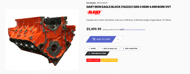

The extra weight helps ur car but it doesnt for most and adding a 100 lbs to the front end isnt a good option for most compared to the Aluminum block considering the dart block weighs 20-25 lbs more than a BGE. They will probably make the same power I suspect or close.
Its $14k for the TKM Hemi Hellcat watered Billet block. Its $10k for the Dart block its not 3x as much. I think ur referring to their other billet Hemi blocks which are more expensive.

We just bought a Dart block so we know it's 5k. Where are you seeing 10k, please post the link.
Here are the new Dart blocks all over different websites:
https://www.dartheads.com/product-c...-3-hemi/cbd-4-090-in/dh-9-250-in/cl-standard/
https://www.summitracing.com/search...p7-XyXQt1VBqhCyccCI9TKeShsOs0qUAjqRm2Nvv_vVSa
https://www.google.com/search?q=dar...g1Njc3ajBqN6gCALACAA&sourceid=chrome&ie=UTF-8
The Demon Performance/Noonan aluminum blocks are 14k or more and then the Visner blocks are over 14k as well. So it's almost three times more expensive to buy a billet Gen3 hemi instead of the Dart block.

The Darts can be had for a little under $5k if the shop is a dealer. That was one of my options and planned on that until yesterday. Our source said we would be waiting on that until sometime in April. Apparently everybody is buying them now. Another option was the new Callies cast aluminum Hellephant. It was $7800 to me. The Dart is officially advertised as 45 lbs heavier than the BGE at 244 lbs. Callies is advertised as 125 lbs. So…. 120 lbs lighter than the Dart. That 120 lbs is as good as hp. Probably worth a .1 off the et. I don’t doubt that the Dart is the strongest cast block as far as how much hp it with contain. The billet blocks are in a different area code when it comes to budget. I don’t live there.
