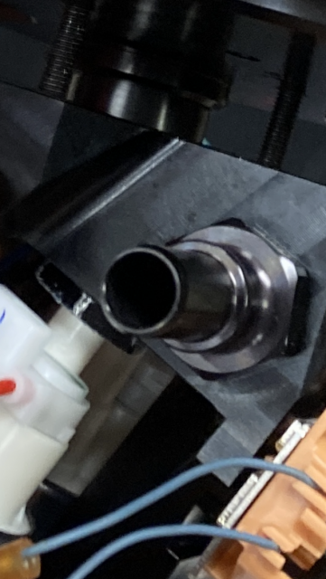

O, one more thing on the pump assembly. The outlet bung, take notice it’s drilled out like I did to the fuel supply line but to .425” ID verse .400 on the fuel line. That left a .037” wall thickness tube, BIG physical difference easily seeable. The reason to be able to drill it out larger than the fuel line is the catch ring is machined onto the OD of the aluminum fitting verses rolled onto like the fuel lines are, fuel line could only be opened up to what the wall thickness of the fuel line was. This helps fuel delivery as well. Good time to remove a restriction if you have access to a lathe and drill bit set. Can be seen here just a bit verse original. 7FCD7D9D-B60A-441C-A211-A987225CE6BF.png 9BCEB447-5EF9-494E-97A6-439712FDAB96.png
