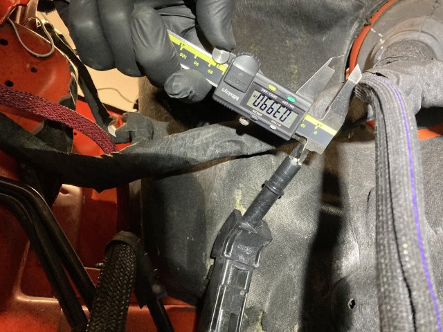

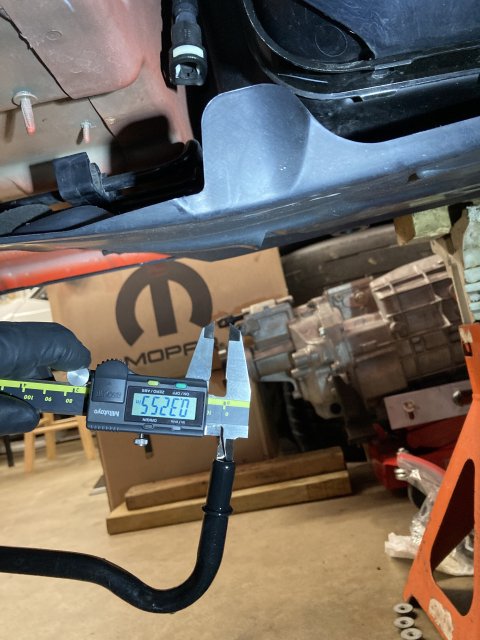

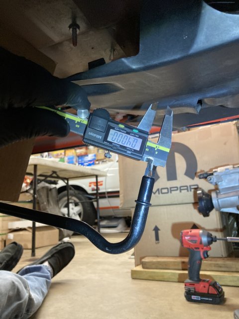

What your fuel pressure dip too? Me, I just don’t like BAP’s, neither do the people who make the pump I wouldn’t think. I’d hang a 3rd pump before I used a BAP but that’s just me. Eventually the stock fuel line becomes too small no matter what unless you raise the pressure even higher and there’s a limit to that too. The restrictions in the supply line design don’t help matters, and they’re easy to remove, again, without compromising line strength or sealing at all. They built them with mass production in mind and to flow what was needed to keep up with stock fuel demand. There’s a reason the Demon and RE WOT fuel pressure was increase verse standard Hellcat it was to make smallish size injectors bigger and get past fuel line restrictions without changing the process in how they were made.

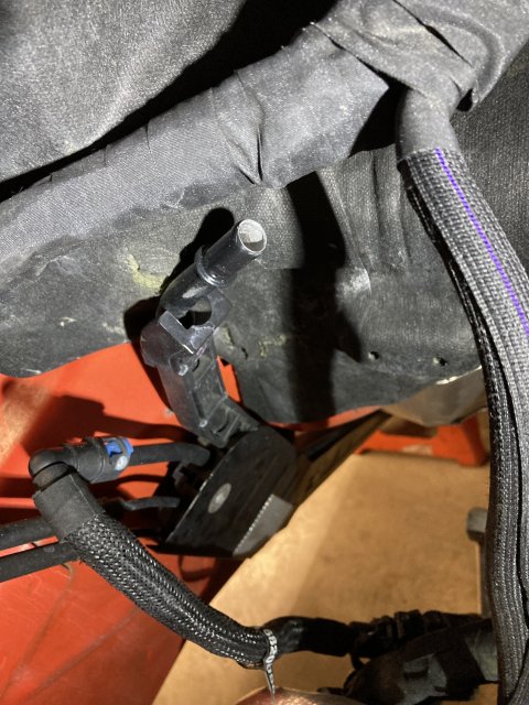

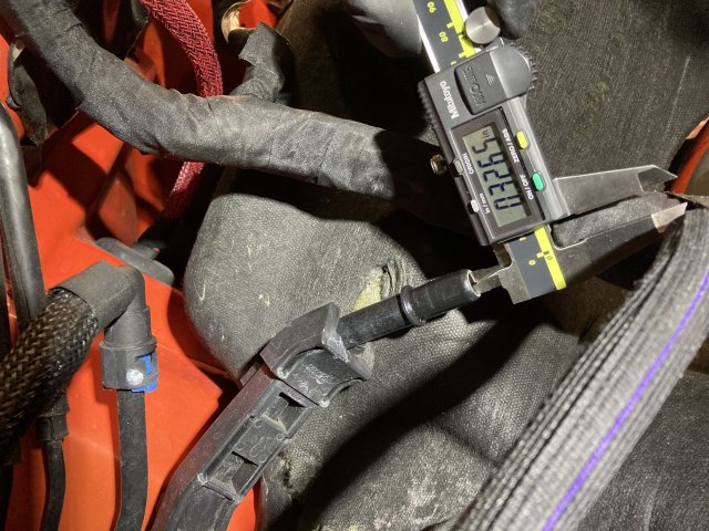

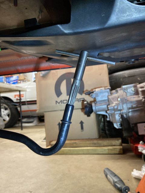

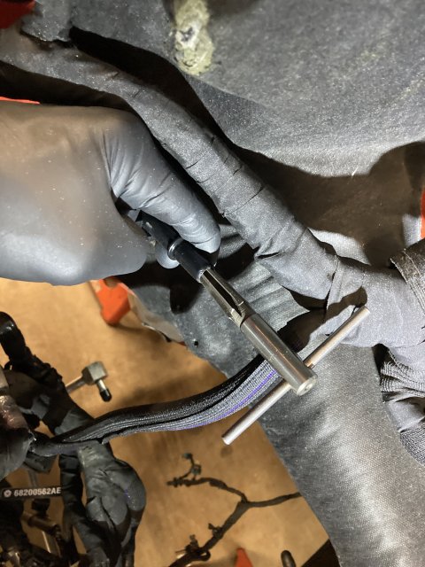

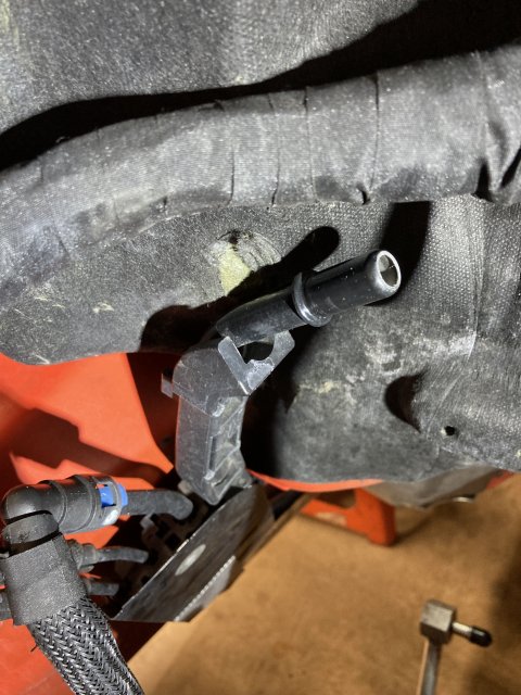

Here’s the first restrictions from the tank to engine bay, like having a restrictor orfice in each end. Easily removed with a reamer, blow line clean with compressed air and done, hour 2 max job. There’s no way removing that stuff can’t lead to an increase in flow at the same inlet pressure, it’s physics not opinion, would something like that be acceptable in the intake or exhaust path anywhere? Of course not. My .O2 at least, a BAP is a band aide plane and simple, a part that can fail, removing the restrictions is permanent and not a failure point as long as one deburs the ends correctly and doesn’t nick a oring in a fitting on assembly, that’s why their rounded, for quick wham bam assembly by folks who don’t care. 1603B4BC-E443-479C-B4A8-EC51EF74B460.jpeg DCCE6634-5BFE-4F9D-B2F1-93F863EB577E.jpeg 3CA4AB12-FBD1-48AA-A799-DFAB64D0A8F8.jpeg E1B5F01D-634E-4A99-A129-6C61D850E69C.jpeg 4975455B-A94B-4CA4-976D-D5AC481BDD69.jpeg EC54367A-D57B-4DC6-A194-060CC636E5E5.jpeg 8E3394B9-D3B1-4EAA-BFC1-D999803A8C79.jpeg B6D683FC-1813-4E6B-9225-7A69BB6FA6E3.jpeg
Here’s the first restrictions from the tank to engine bay, like having a restrictor orfice in each end. Easily removed with a reamer, blow line clean with compressed air and done, hour 2 max job. There’s no way removing that stuff can’t lead to an increase in flow at the same inlet pressure, it’s physics not opinion, would something like that be acceptable in the intake or exhaust path anywhere? Of course not. My .O2 at least, a BAP is a band aide plane and simple, a part that can fail, removing the restrictions is permanent and not a failure point as long as one deburs the ends correctly and doesn’t nick a oring in a fitting on assembly, that’s why their rounded, for quick wham bam assembly by folks who don’t care. View attachment 87538 View attachment 87539 View attachment 87540 View attachment 87541 View attachment 87542 View attachment 87543 View attachment 87544 View attachment 87545

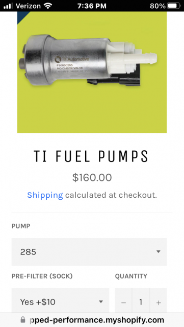

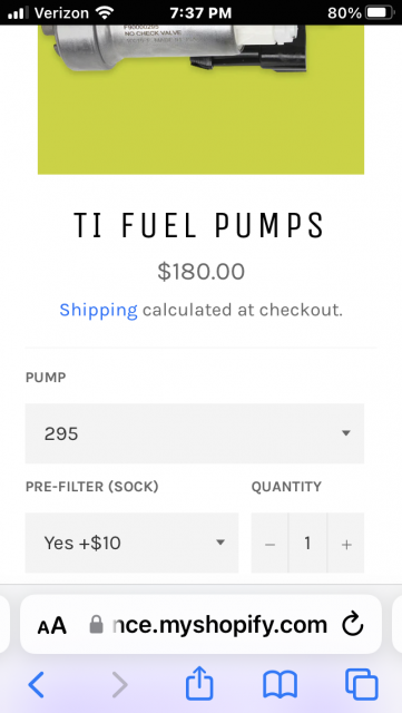

You’re better off getting a new one, or better yet a pair of new ones from Rick at Tapped, keep the removed still good one as a spare. Or even better upgrade to dual 295’s, don’t let the No check valve thing scare you as startup is no different, for me at least, it’s instant fire on crank. One draw back of no check valve is if one fails you have no fuel pressure which in a way is a good thing as it acts just like rpm limiting fuel cut not starve your engine unknowingly like having 1 of 2 (or more) fail and you starve your engine of fuel but thank God proper tuning will open the bypass and shut you down quick over 90% DC. Bad part is there’s no limping home, one reason on my list to go to triple 285’s. I read somewhere once that with running E85 it’s recommended to replace the pump(s) every year, yea, WOW aye? I can’t find that article again now, may have been on Fore’s site as Ti says life is 10-20 years on their site?? If their out of stock and you can’t get one let me know I will send you one of mine no problem.
https://tapped-performance.myshopify.com/products/ti-fuel-pumps
Buy new filters for just 10$ each is highly recommended.
