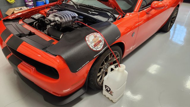

I have threaded fuel rail ends and thought I get get a fitting if I wanted to do that
7,471
19,633
Thread Starter #389
I tried welding an AN fitting on the end of a factory rail but I learned the rate of flow matters. It has to be restricted enough to create a vacuum so the passenger saddle venturi sends fuel to the driver side saddle where the pumps are. If yours are threaded will likely work, you just may have to put a restriction in the hose (like bending it with your hand or something).
4,385
10,906
Need to teach @jonx96 that one;)
Ive done this many times my 18 had the same thing. Some how my Scradder valve broke this year. I finally got it out. But now worried there is metal in the rails. So i need to clean them.
60,848
212,412
You cycled the fuel out, speedy turned it on and it emptied
4,385
10,906
I have a jumper wire. Just don’t use it unless it is full
