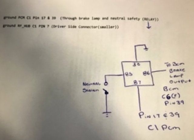

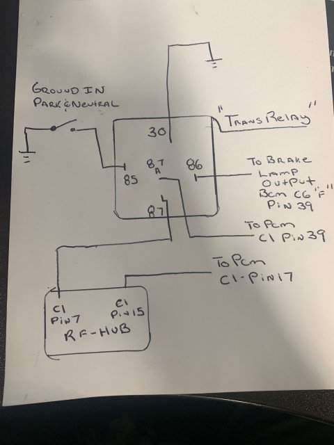

“Crappy relay diagram”. Haha. Here’s mine…. Maybe it will help 😂 6D39F5BC-687F-4737-8291-8561FB67AA58.jpeg

Hell I don’t know lol. You can see the BCM brake lamp output is being used for the starter. So the car won’t start without a foot on the brake. Obviously there’s more going on there than just that but automotive wiring isn’t my thing. This is what AJ sent when asked for a diagram.

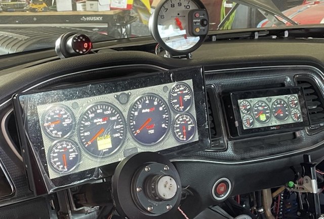

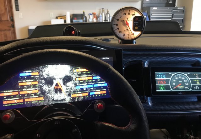

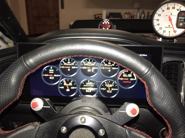

I can tell you that the Holley Dominator with its capabilities is astounding. It works with you instead of against you. There’s no “dealing with” or working around obstacles. The programmable digital dash is a wonder. It is a touch screen that can be configured to look like and tell you whatever you want. Tired of looking at one? Touch next and see another one with different info. 590DDFFC-3184-4783-8650-1D4F8553FA52.jpeg 3B7DF2FC-6EE4-4055-81C7-2687B8BBBF90.jpeg E3A8BE2B-124A-4054-BC4D-8566F819474D.jpeg

I can tell you that the Holley Dominator with its capabilities is astounding. It works with you instead of against you. There’s no “dealing with” or working around obstacles. The programmable digital dash is a wonder. It is a touch screen that can be configured to look like and tell you whatever you want. Tired of looking at one? Touch next and see another one with different info. View attachment 104123 View attachment 104124 View attachment 104125
iving me really bad ideas @Marc W
