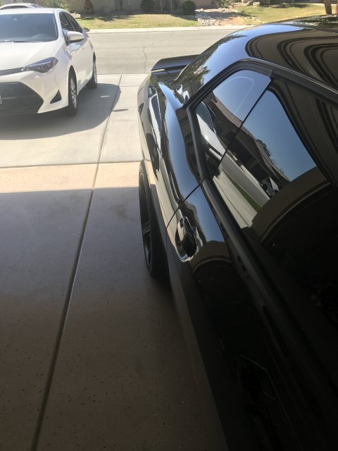

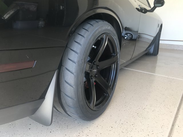

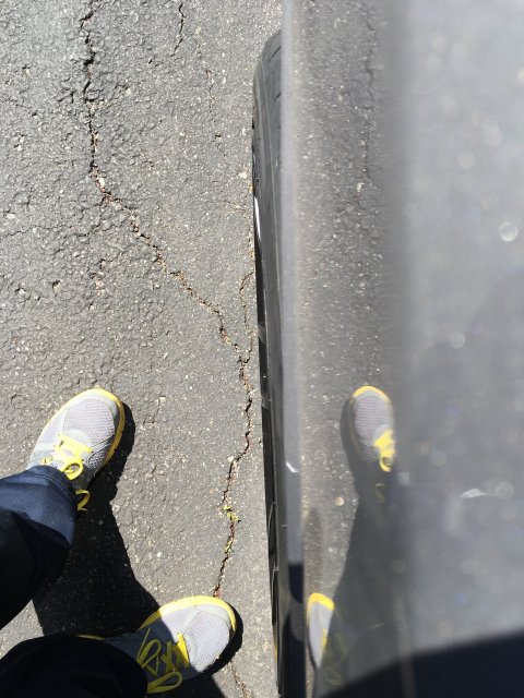

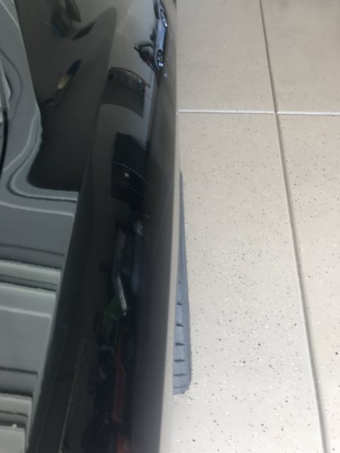

Pics of mine with the 11" rims and 305s on the rear
Here is a top down view

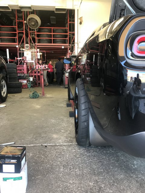

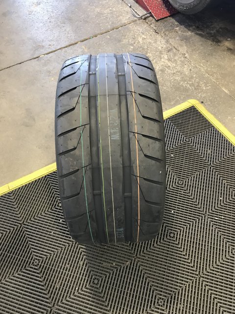

I haven't seen a 315/35 tire fit on the back of a Challenger yet that didn't rub or poke, regardless of offset. You MIGHT be able to get a 315 Nitto drag radial to fit, but only because they run narrow.
Primetime Hellcat 17
#949
687
974
2017 challenger Hellcat

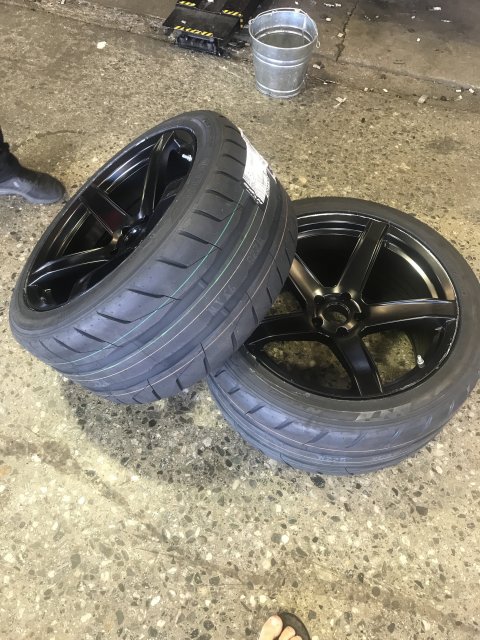

I’m running a 315 tire in the rear on a 11 inch replica with no issues on my Challenger! It looks badass with that staggered look.315/35/20 traction is awesome. DBB0B01B-F0D7-4FA4-9FD7-67B4628D95CB.jpeg AE332D36-EB15-4F3C-8B50-883E693B18B1.jpeg 4C273015-8278-42AD-AC5B-514F51CC0AC1.jpeg 737AEDCA-341A-44BA-B98F-825F150D1043.jpeg 9FF7B141-AADA-4340-963F-1028E3787596.jpeg 76FBAB5C-2501-4458-B5BF-76BB2C8AE9BE.jpeg A297359F-D50A-46D5-861C-C01B7D1A01E5.jpeg 5BEBE4A3-FC04-4D4F-81A8-095BEE819257.jpeg
coolblue
#1172
1,577
2,696
I’m running a 315 tire in the rear on a 11 inch replica with no issues on my Challenger! It looks badass with that staggered look.315/35/20 traction is awesome. View attachment 8917 View attachment 8918 View attachment 8919 View attachment 8920 View attachment 8921 View attachment 8922 View attachment 8923 View attachment 8924
Who's rims you using and what offset? Those are exact replicas of my RE rims and would match perfect. Also those tires are Nitto's correct? @Blkout, as I have read elsewhere, said they run a little narrow so maybe that's why the success. BTW don't want to steal the thread but how's the King Kong cam doin'?

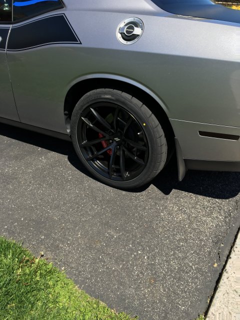

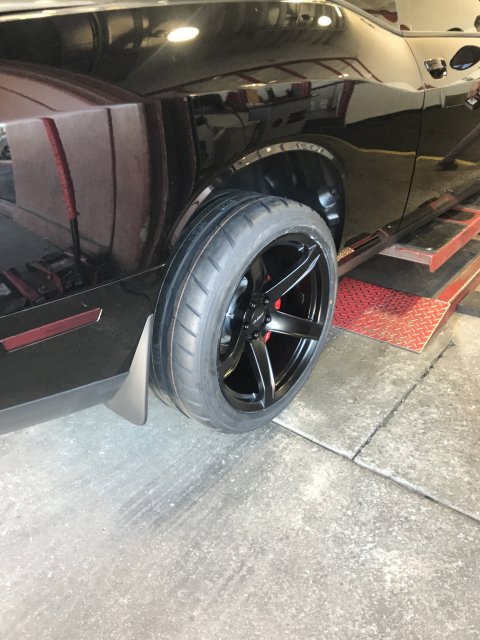

11.5 with correct offset so no inner wheelwell mods required.
(Without flares/with flares)
20×11.5 335/30 (Rear)

Nitto's might be the only exception since they tend to run a little narrow but not everyone wants to run a drag radial daily though. For non-drag radial street tires, a 315 isn't going fit on a Challenger without poking or rubbing.

I don't know how much trimming it would take to make a 325 or 335 fit without poking out. The only way I know to do it is like @Hunter and I did using a custom offset wheel and Phillips Performance flares. With the flares and the right offset, you can run a 335 or 345 tire on the rear.
