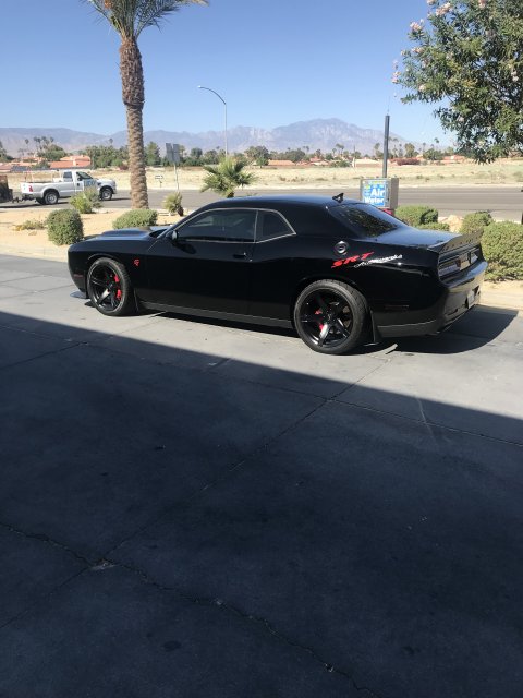

I’m running a 315 tire in the rear on a 11 inch replica with no issues on my Challenger! It looks badass with that staggered look.315/35/20 traction is awesome. View attachment 8917 View attachment 8918 View attachment 8919 View attachment 8920 View attachment 8921 View attachment 8922 View attachment 8923 View attachment 8924

D5DA4C57-09DB-4155-B3B7-32C7E3BFCA8B.jpeg 3ADD4CC6-491B-49E5-9795-829F1766B3D6.jpeg A8976EB5-7E24-4C38-813D-AA6C61856DD4.jpeg 2B5E941F-1653-41D1-A351-A824BD0934C9.jpeg 5666361E-0EF4-4042-88B4-752C8CC34333.jpeg
Here is a few more pics with the 315’s on a 11 inch wheel.
