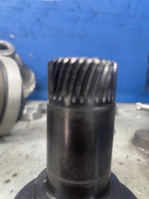

I have to respectfully disagree. I bought GForce Outlaw Axles. These are supposed to be the billy badass of axles. I have 15 passes on them and then poof. At 2200 a pair these are not cheap. So what you're saying is that for my street car I should get a TH400 and full solid rear axle… to run 9.5 class.
Make it make sense?
. What I’m saying is concerning the differential. In my opinion, the stock diff case has proven to be a weak point. At the 1000+ hp level it can pretty much be expected to break at some point. Your options are the new billet replacement with stronger (Wavetrac) LSD or go to a DSS 9” conversion with the 35 spline stub option. Either of those will prevent what at this point is just a matter of time with the potential for extended driveline destruction. Axles are a separate issue. I ran DSS with 35 spline stubs with their 9” conversion and never had any issues running 1.2 sixty’s.

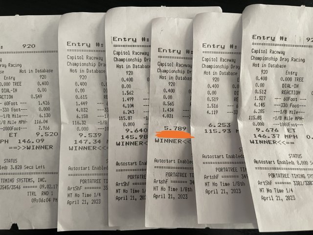

From what I have seen they are a really strong axle but not as strong against wheel hop. @jgilj cuts low 1.3 60fts on them

What the heck are you doing at the launch to break axles at that power level? I ran the factory axles and factory diff for at least 3 years of racing every week at the 9.4-9.5 ET and 1.3x - 1.4x 60' without issues. I did break a factory axle once but replaced it with another factory axle which lasted until I decided to replace them because I wanted to spray it. At that point I took the path Marc W is suggesting and decided to prevent a failure by upgrading parts that could potentially break and installed the DSS axles.
You might want to consider softening your launch some in the tune.

I didn’t know a 1.4x needed to be dialed back. @Jon-MooredPerformanceLLC

I'm willing to bet the axles were defective from the start. A 1.4 60 at this power level should never have twisted let alone broke an axle. Add in some wheel hop and you have a much different story. but the fact it still went on the pass is weird. every axle I've snapped, sheered, twisted or exploded left me sitting at the line.
