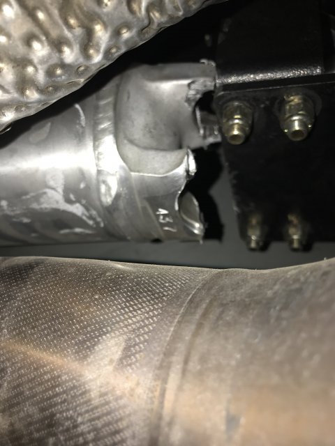

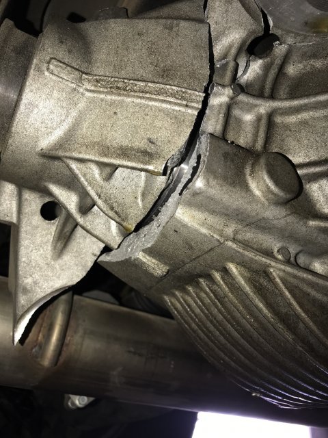

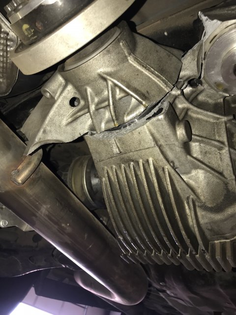

One of the shop Hellcats made a mess of the starting line in Vegas last month. This one has the full AAD with diff brace and lockouts. Also broke the driveshaft at the front. Have to wonder how the trans liked that. I think this would be a argument for that billet rear or a 9” conversion. 11901D3D-4706-49E7-872C-DC0B0EBDDC44.jpeg 3AE10394-CA45-4EA4-B1D2-10F65F532DC6.jpeg 359AAD75-8B08-4EB8-9F6E-914C07E713F4.jpeg

Thread Starter #40
Something to consider. Breaking stuff… breaks stuff. Some take the approach that they will upgrade when necessary. Meaning when it breaks. A perfect case in point…. The Magnum at our shop is still running a IRS. It has a Ford 8.8 in it that has held on. We were wondering how long it would last and plans to go to 4-link with the Strange 9” like mine were discussed. It was hanging in there running 8.3’s and on top of the world. The long, expensive trip to Houston was made to wring some more out of it. And…. it let go on the first hit with that track prep. They found a replacement ring and pinion at a local Ford dealer and spent the night getting it done. Next day they were back in business…. Until they weren’t 🫤. When the rear end let go… it hurt the trans. That was discovered when the $12k T400 let go in the burnout. The point being…. It might be smart to bite the bullet for the expensive parts up front. Sometimes saving money… doesn’t
I have to respectfully disagree. I bought GForce Outlaw Axles. These are supposed to be the billy badass of axles. I have 15 passes on them and then poof. At 2200 a pair these are not cheap. So what you're saying is that for my street car I should get a TH400 and full solid rear axle… to run 9.5 class.
