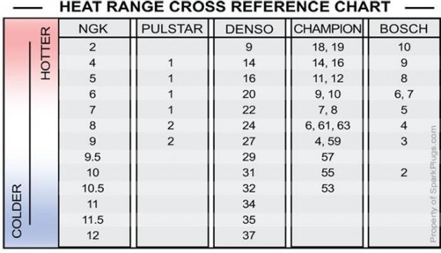

Resurrecting a dead thread? Im potentially seeing 18-20 psi now. Saw 18psi on a quick blip. What is the appropriate plug range and gap for this?
20,159
Nice chart.

The 2309 NGK would be 1 heat range colder. I have been running them this year and so was @jonx96 and @16GoManGoHC2

At your boost prob. .026 > .028

I used to run .030 at 20 psi on my Mustang. I gapped mine at .028 on the Hellcat. You could go lower if you want

So if I remember correctly - the stock plug is Bosch heat range 7.
The NGK heat range 7 is 1 step colder.

Got 16 of the LFR7AIX at rock auto. 107 bucks, considering the economy I'll take it. Also got a spark plug gapping tool from Amazon, not going to play games on this go around considering the time it takes to get them out. Now next is choosing a gap. Conventional wisdom has it at .26, still haven't heard from @16GoManGoHC2, I Know @zhc has a very high horsepower car and so does @Marc W any recommendtions from you guys?

I’m pushing well north of 1600+ whp, not exactly an apples to apples comparison. I prefer Brisk but there seems to be a fair amount of folks who have experienced issues with them. I personally have never had an issue. I prefer them over NGK iridium’s because they’re more likely to melt before actual real damage occurs if things get too hot for whatever reason,
Real example, had a guy’s ice tank pump stopped working before a pass and melted plugs in one of the cylinders on what would have been a mid 8 second pass. I believe, if it had ngk’s in there, it would have hurt something else instead.
As for plug gap, if there’s a question on whether to go bigger or smaller, try smaller. Saves you trouble later if/when it blows out spark cause the gap is too large.
Normally I recommend .025 - .026 for a setup like yours. Use whatever brand you’re comfortable with.
3,680
8,687
thank you, @16GoManGoHC2 thoughts? I saw you hit 20psi the other day
NGK 2309 at .028 have been working great. Remember the bigger the gap the bigger the spark and more molecules get lit off. I’d go no bigger then .028 at 20 psi, in good air I’ve seen 22 psi and no problems at .028”
