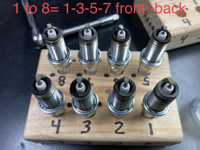

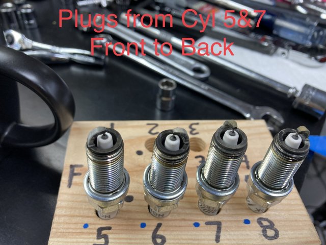

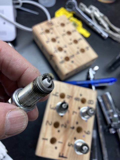

This is the plug I’ve been using for 3 years now too, never gave me a issue, gap them at .028”. Here’s a picture of them after about 2500 miles on corn since new. Notice where the heat band is in the ground strap, about right at the bend where it should be, it can be seen how it migrates back and forth between the root and the bend from part throttle to full throttle operation. Notice the soot ring on the threads, about 2-3 threads deep like it should be. This is 17.5 psi of boost on E85 making about 930 wheel. Engine likes this heat range of plug, I thought about trying a non extended tip type next but this one is running nice why change.
View attachment 62023 View attachment 62024 View attachment 62025
Ran across your post from the "hood" You said they were stock heat range which is a 7 and these are a 7:)
3,684
8,687
Ran across your post from the "hood" You said they were stock heat range but I'm sure you know they are a step colder being a "7" and stock is "6"
Didn’t know that at first but caught it somewhere along the way and was happy to hear that news but THANKS for pointing it out here again. It’s why I mentioned all the stuff about ground strap showing heat range is good and soot marks on threads showing the same thing backing up the one heat range colder you mentioned is liked with increased boost and corn. I like this plug too!! 👍

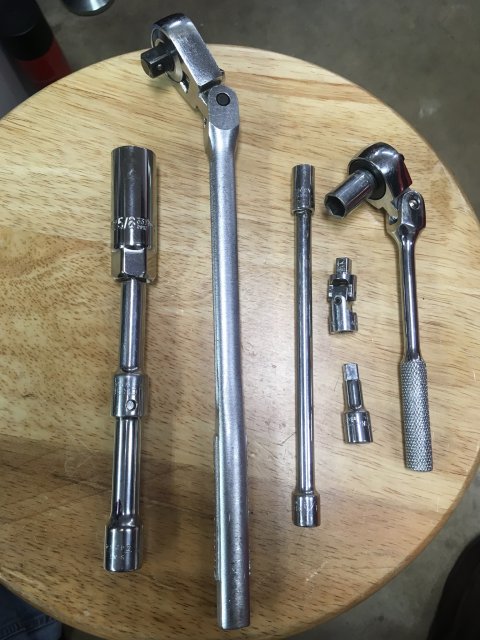

Based on most members here, it sounds like you should do up a dedicated thread showing your tooling setup.
@fumanchu182 about lost his temper more than once doing it.
Just saw this, here you go

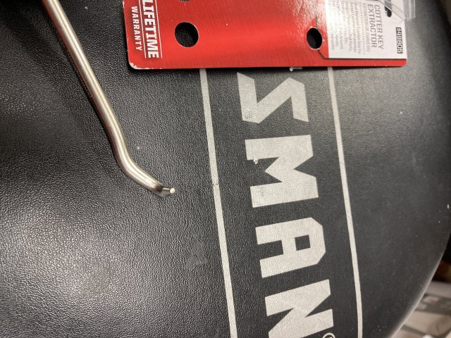

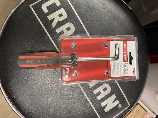

Use this cotter key remover to push the E connector tab in and push the connector off. Dull the tip so it doesn’t poke through the tab.
