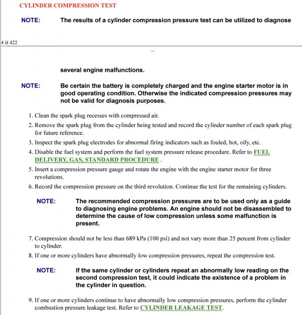

My stomach hurts from reading all this, I couldn’t find anything in the manual that says what the actual compression should be. @16GoManGoHC2, How did you find that number?
When I did the test the intake was off but the throttlebody was not blocked. I am going to the track this Friday and if the car does not perform the way I want it to then Plan B will be put into motion.
Compression tests of my own engine when new and that of a few others before modding for baseline numbers to know when it’s deteriorating and needs refreshed. Each one has always been around 210 psi with little to no variation between cylinders. Compression test and leak down testing is yearly thing I do to engines I beat on. Leak down test a good practice to do even to a new engine while it’s still on the engine stand to know leak down even before it’s first started.
When I say throttle blocked open when doing a compression test I’m meaning the throttle body butterfly valve held wide open while cranking.
I definitely did not have that blocked open. It was closed. I wish that the FSM had better instructions, this is what I followed.

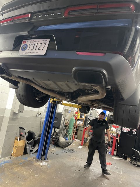

Im not playing around anymore. Had the car on the lift. Everything was reviewed. Not a damn thing loose. So I have solid motor mounts, no mufflers and no resonators. Should the following not work I’m desensitizing the knock sensors.
I’m fucking sending it tomorrow night. If she blows well fuck me just have to build a race car.

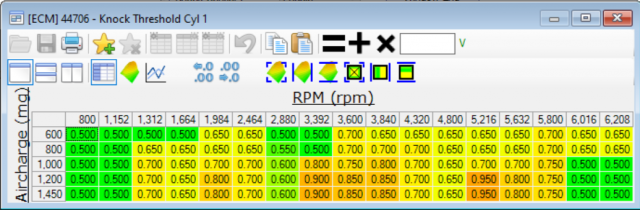

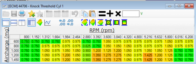

I'm in the tune right now and playing with the knock sensors. If I understand you correctly most tuners max out at 1.6v and then stop. So theoretically if I increase the numbers in the table the threshold should be higher and less chance of knock removing timing. I plan to run a conservative tune with the knock sensors moved up and then increment timing by no more than .50 of a point after each pass. Incremental. Stock numbers:
Then the increase in threshold:
In this example it's 1.5x, that might be high but I was just playing with the tables to figure out how they work. Is this correct @16GoManGoHC2 ?
Yes, 1.600 volts. Yes, tables look good, That’s a pretty first jump, by 5% I meant times the values by 1.05 not 1.5 lol but those numbers you have in lower table should not hurt your engine up, I’ve seen tables at 3-4 volts already! Send it!! You have a 9.xxx coming I just know it 🤞🙏👍👍
