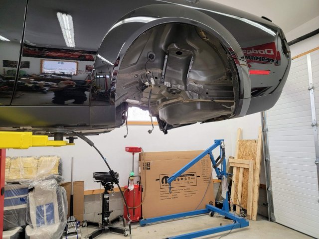

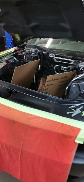

All these missing engines

ok Jim we want your blood pressure instead:geek: an your body temp every time you think about your car
It would have been interesting when I turned and first saw it. Especially after not expecting anything to be done. I was going to bring it home while we waited for news.

Moparjim's car is In getting a warranty engine .
Demonsrt is trying to upgrade his suspension and is having a hell of a time getting parts
And 16gomango had to rebuild his engine and is stuck waiting for parts so none of them can start their cars . I figured I'd throw a dig at them .
