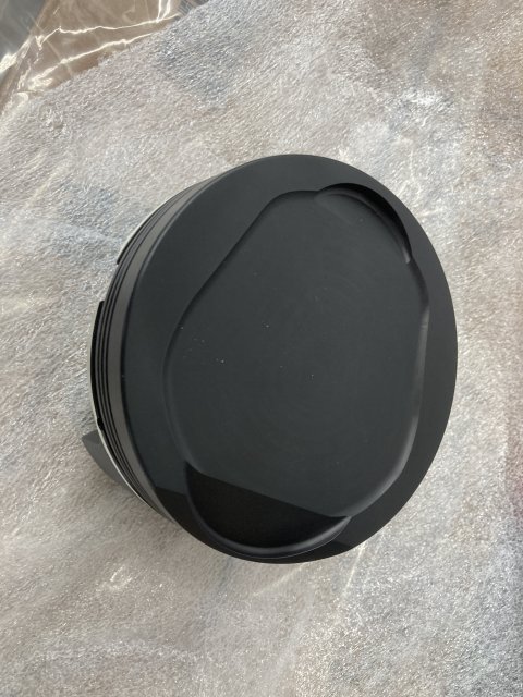

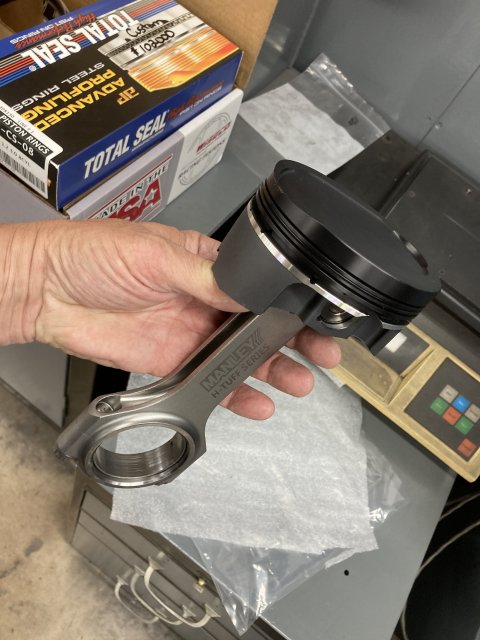

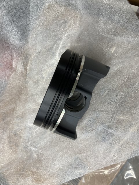

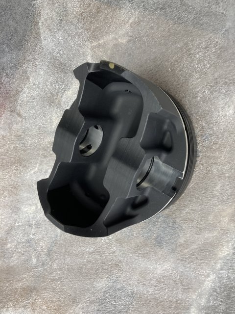

Piston kit finally arrived, look at these babies
4F77E4B8-0290-4ABA-BE9B-BA9CBF0D750D.jpeg 4B50777B-1D30-45A6-BBB2-5233A4A8CFE8.jpeg 69EA1F91-D375-48BD-98A0-42046805CCC2.jpeg 62C074FA-9DF3-4E14-B759-AC46B775C55F.jpeg
Thread Starter #1,825
Nice ! Very nice . Looking forward to the assembly.
6,921
17,850
Dang that top ring land is serious! Now start a build thread LOL
