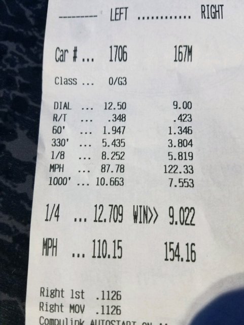

I am not sure, too much nitrous use, this year my best was 9.02 with a DA of 3,000 to be conservative, he has the record, however, I can run 8's on boost (2.3 blower) on anything under 2,000 DA. Summit owns a 2.7 L blower, has he stated it was with a 2.3 L hellcat blower?
