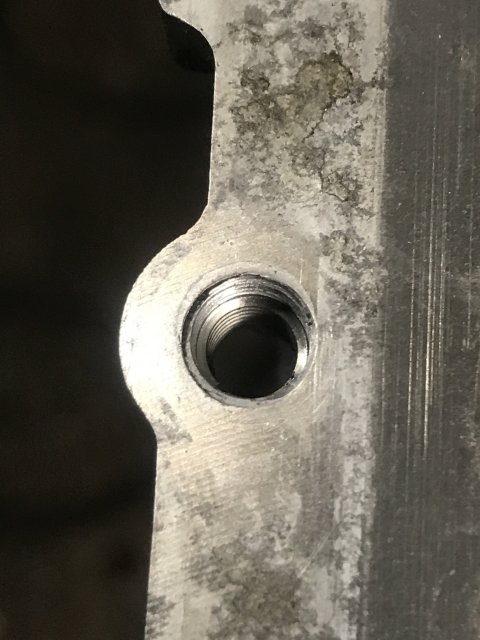

As I mentioned earlier in the thread I had two of the pan bolts break off when removing the pan I tried to extract them but they were seized up and I drilled and tapped them and installed helicoils, so be prepared for this possibility as well as of you pay a dealership or shop that an additional cost may be added for this service 174F61E3-CC6C-4A5D-A570-A1D38944B3F8.jpeg
