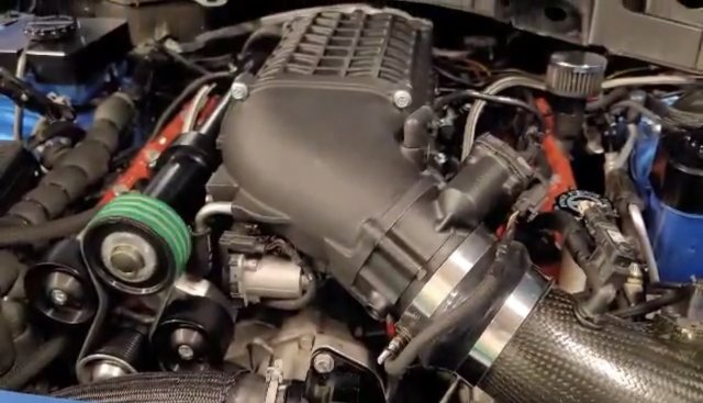

Started up today. Had a couple day delay due to the fuel rails being -6 fuel line compared to the -8 that was on the FORE rails. Tuning in the next couple days probably.

I'll be curious how the noise on the knock sensors look with this blower replacement. I've read a few places that the stock blower is pretty noisy and I've sen it personally right around 4,000 RPM on mine.

You mean stock blower whine falsely triggers the knock sensors?

A LOT actually, and the smaller pulleys make it worse.

Shouldn’t be that sensitive. They sit in the motor. But some have had false knock issues when pulleying down. Hell....maybe it’s the intakes lol....

It's not just about the "sound" it's the frequency of that sound and what the sensors are programmed to listen for. The factory supercharger definitely sets them off to a large degree when pulleys are changed. Took me a bit to come to terms with that, but in my car's case it was only right around 4,000 RPM. I had to do a lot of testing and visual checks of the exhaust (filmed it) at WOT to confirm.
