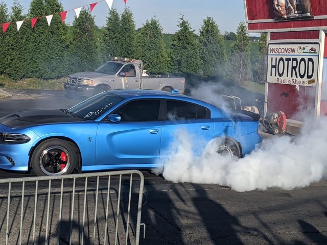

First passes on the new setup. Can’t thank Jeremy Satera enough for the support. New PB with the car. Got two good runs in. Only made three total, track was packed. The car has a lot more in it. DA was sitting around 2400 for one run and about 2000 when the sun went away.
I need some more seat time to let this thing rip off the launch. This is my best 60’ ever with the car. We will also have to play with the timing on the launch. I think we can throw more at it with this 315/50/17. Didn’t even hear a tire squeal.
Car was making only 16-17psi 🙃

Excellent results. Makes me look even more forward to what mine will do.
3,631
11,716
#58
Nice! Good job!

Thanks. Has more in it for sure. Need to get the 60’ to low 1.4 or high 1.3.
Got a tune revision after each pass and have one more to load that should help. Car was short shifting before the 60’ so we fixed that. Should help some.
