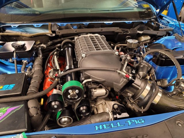

Thread Starter #77
Might have to take off that 105 spray plate. Hood won’t close due to me running the FI spacers. We think it is the 105 Nitrous plate, I’ll know tomorrow...... 9E0812A8-9E93-420C-9510-C722D94F8EF8.jpeg
3,631
11,716
#78
Might have to take off that 105 spray plate. Hood won’t close due to me running the FI spacers. We think it is the 105 Nitrous plate, I’ll know tomorrow...... View attachment 22957
you can space the cradle a half inch to buy some room if you need to. Others have done that and haven’t had any issues as far as I know.
4,556
9,452
#79
Put some washers under your hood latch... keep the nitrous at all cost!:ROFLMAO:
WhipCat
#985
1,500
3,871
In the Jungle
#80
I spaced the cradle to make it fit. But I don’t have the FI spacers anymore. Had a custom spacer made for my whipple. @Marc W has one of the fancy spacers made down here in Florida also. There’s only 4 or 5 in existence. And they work well. You might want to see if gearhead makes one for the magnuson.
