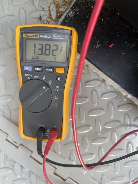

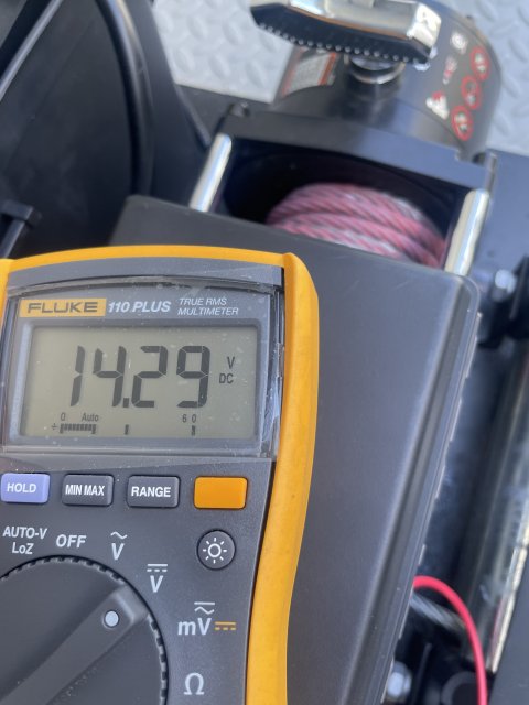

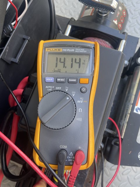

@BULL @Jimmy N. @Unholy707 I apologize, had a wiring issue. Didn't pull enough sheath off when installing in terminals.
power from pv array
power going to battery
battery power

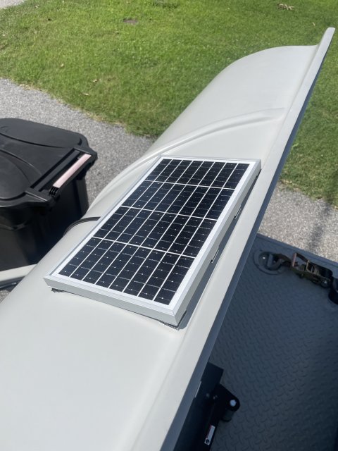

also in direct sunlight
power from pv array
battery power

An you please adjust the Velcro on the cell? It’s driving me nuts 😉 (just kidding)
