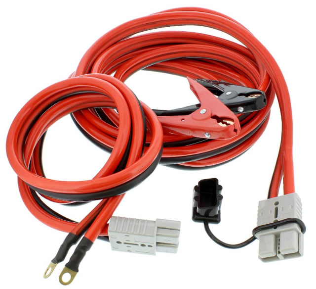

From what I can tell this was a cannibalized 1500 amp jumper cable set. They run about 60 on ebay. Theory is undo the nuts on the clamps and attach to truck battery up front. Would run it along the left frame rail and route to the hitch from there leave some extra feet to cross over, when done i would fold the cable and store in the underside. The wireless remote is nice!
then buy one of these and just change the clamp end to battery terminal ends
6,408
11,976
Yep, that's the kind of cables I intend to use. Thankfully I already have all this stuff, so it's just a matter of laying everything out correctly.

Do you have the connectors?
https://www.amazon.com/X-Haibei-Battery-Connector-Connect-Disconnect/dp/B00KXKW6WC
I was thinking of just buying these and then getting cable elsewhere but it seems the path of least resistance is just cannabilizing a set of quick disconnect heavy duty jumper cables.
6,408
11,976
Yes, I have a couple of complete sets.
Still haven't decided if I'll use clamps for the tow vehicle end or connectors. Nicest would obviously be connectors in both ends, but not expecting to need the boost for the trailer battery very often....
Time will tell what I end up doing. If I left both batteries in the trailer I wouldn't even worry much about it, but I'd like to get rid of one of them.

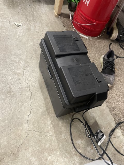

Picked up the battery box, terminals, and cables for under a benjamin. This was from my research:
https://www.amazon.com/dp/B004W5SGBO?psc=1&smid=ATVPDKIKX0DER&ref_=chk_typ_imgToDp
https://www.amazon.com/dp/B08HZ98FSR?psc=1&smid=A16J9KFCZQ3JX5&ref_=chk_typ_imgToDp
https://www.amazon.com/dp/B084TV3SMV?psc=1&smid=AN5LAOOZPYBYF&ref_=chk_typ_imgToDp
Just enough chinesium to kill me probably... or make my dick glow in the dark.
6,408
11,976
Nice.
I like those battery boxes, use them for fuel tank pumps sitting in the open. Easy to run wires and cables in and out of.
On one I put a cheap digital voltmeter (on a switch) to quickly see how the battery is doing.
Those 1 ga cables are far better than the 2 ga ones I have. You just cost me some money.
And the battery post terminals would allow me to use a larger battery (which I already have) in the trailer's tool box. Thank you for finding them for me.

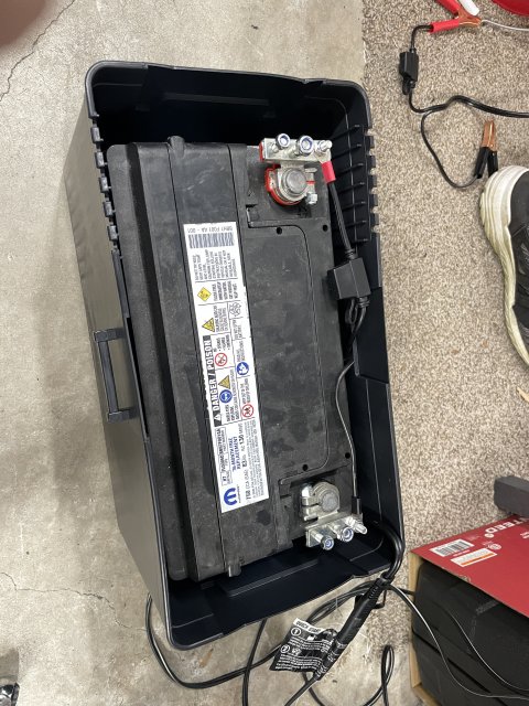

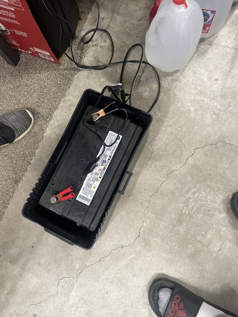

Plenty of room for a big boy battery.
5D2D5D08-7B2E-40F2-A9D9-0824E36D4ED1.jpeg 4BC6A72F-C871-4663-952A-FA7CDA64742F.jpeg
6,408
11,976
Looks good.
I'm rethinking my whole battery/cable situation. Will still need the nice jumper cables you posted earlier, but can probably fit the battery in the front toolbox.
That'll allow using much shorter cables for the winch, and then smaller gauge ones going to the hydraulic pump and compressor.
The space lost in the toolbox would partially be made up for by using the room the batteries in the under bed boxes is occupying now. Glad you got my going on this project.

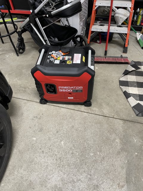

Decided to just buy a generator
Ended up getting it 30 percent off they let me stack a coupon don’t think that was supposed to happen 😊 89AC124A-97EF-4E5D-8025-7D0881EE3704.jpeg
