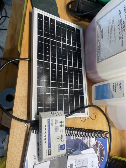

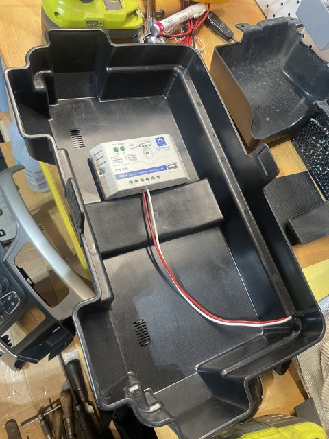

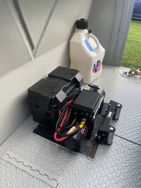

Added a mod to the battery system. Never got around to running the hard wires under the truck and fuck all can’t be bothered to now with the Hellcat in eternal slumber. First cleaned up the wiring and finally put the lid on.
immediately pulled the lid off to start a project
the kit can be found here) https://a.co/d/9aPQNno
Attached the PWM module to the lid with outdoor velcro:

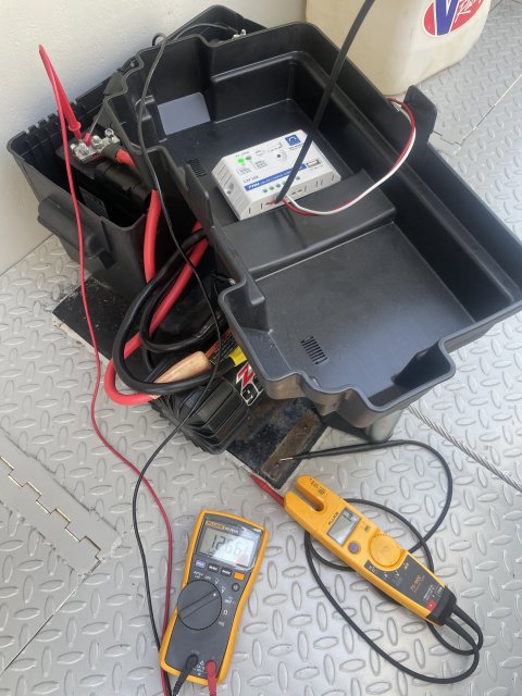

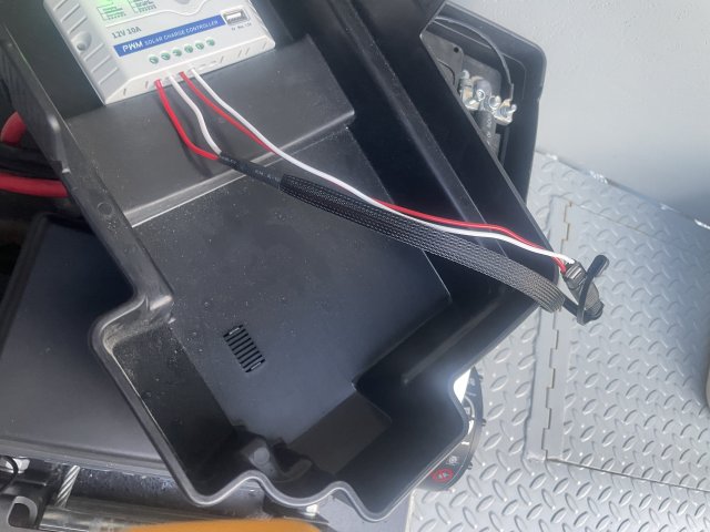

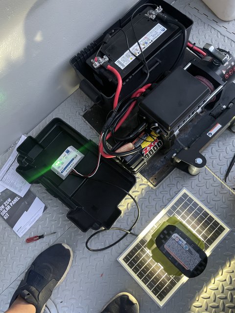

Spliced in a battery connector to attach to the existing one. Did a test since it was getting dark out. Tested load and charging with a spot light.
the closed it all up right now its in a temporary spot till i figure out where i want final location to be
going to check voltage in the am and the chrck again at end of day
in sun its pumping out 21v in the dusk hours 14v and as expected nothing at nighttime

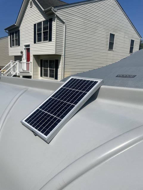

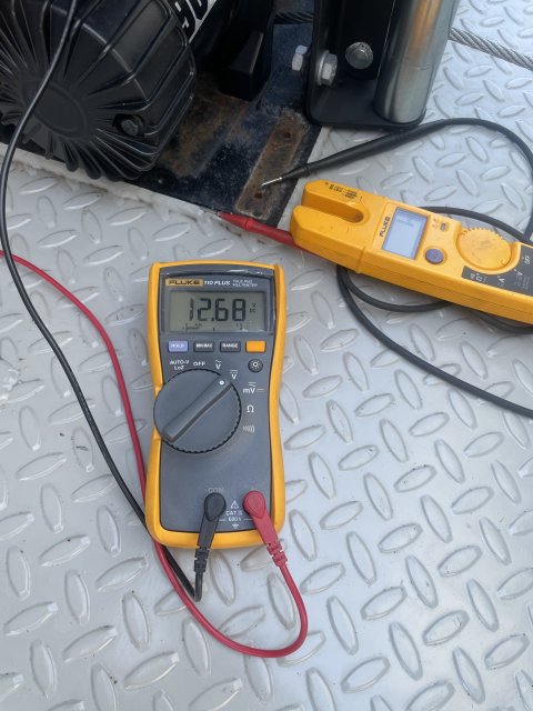

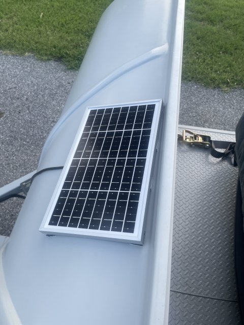

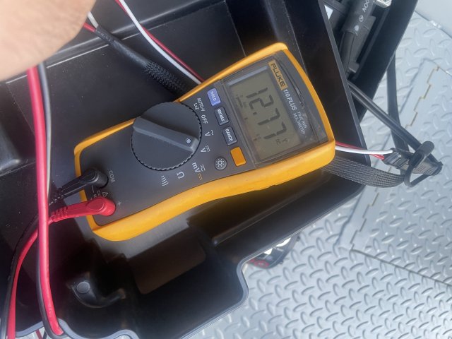

temporarily moved the panel to its final resting place. The PV cell was putting out 12v easily.
Going to let it soak for a bit. If I like the voltage increase then ill velcro attach and let it be all summer. Real test is when the winch goes through a few cycles.

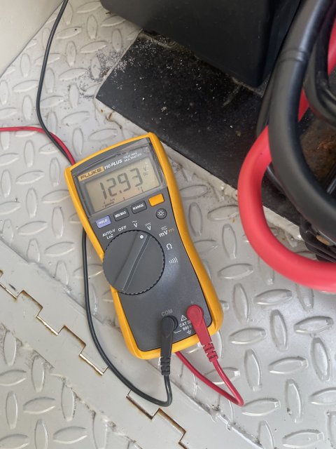

46 minutes ago batterY was at 12.66, just checked
To answer your question @Unholy707 … yes.

Is that charge controller a good match for the battery type?

Yes. It allows you to select your battery type. Sealed, agm, flooded. Its a hell of a controller for the small price.
6,899
12,821
I've had good luck with Renogy controllers. One of them even lets me pick between 12 and 24 Volts.

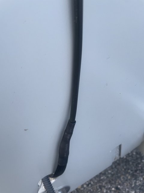

Final wire up.

Do you know if it peaked at around ~14.5vdc?
It did not, even my 3amp battery tender keeps it at 13.3v. An alternator pumps out way more power than these devices.
