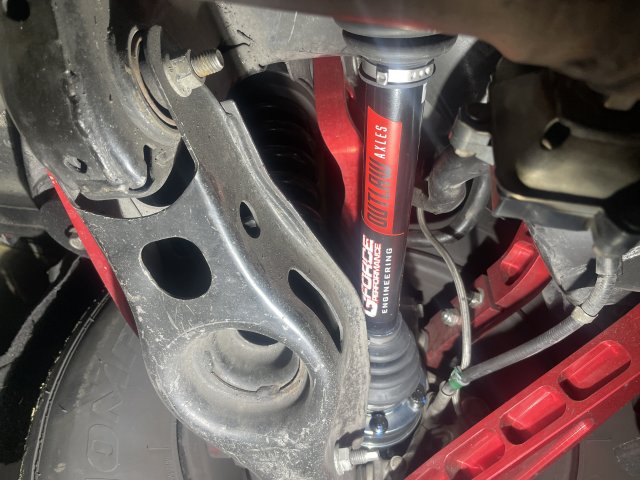

@16GoManGoHC2 got under the car today. None of the diff shell is broken. Axles where given the shake test by hand, seem fine. Trying to find a Demon diff. The regular 3.09 aint it.

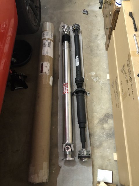

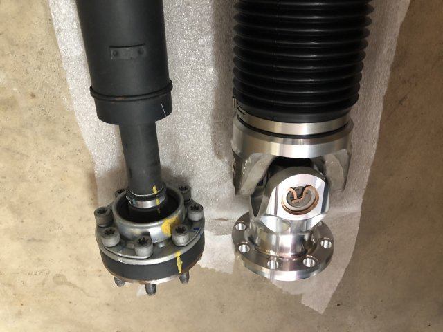

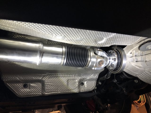

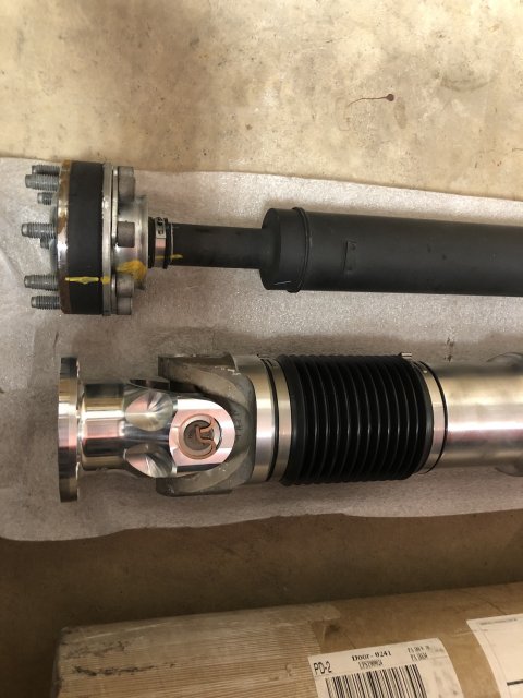

Man that spindly little shaft on that CV style DS is scary looking. You need one that looks like this, DS breakage is not even a concern of mine, the Wiles is like a Battleship compared to it.
Yea, find a Redeye 3.09 Diff is what you need 6E08615D-4DAC-4015-A298-2862DFC5DCC6.jpeg 061ADB78-3D2D-42C9-A17B-B8F1D6AC8CD9.jpeg 23CFD83D-3771-405C-9C3E-C8104E7AB081.jpeg

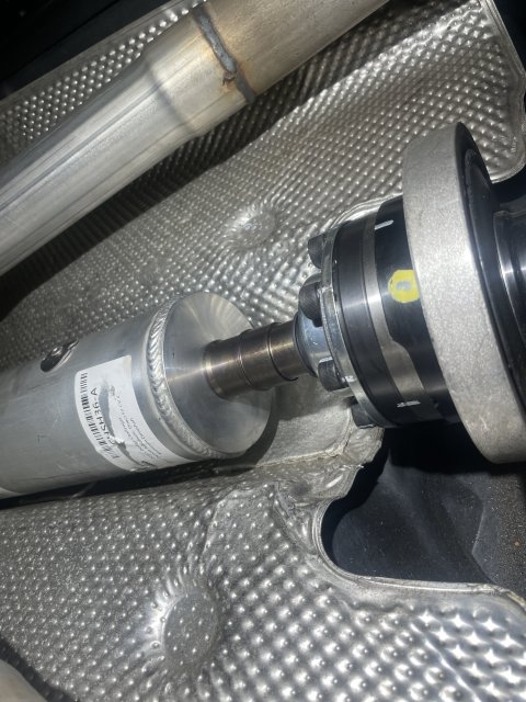

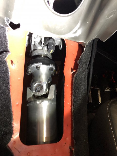

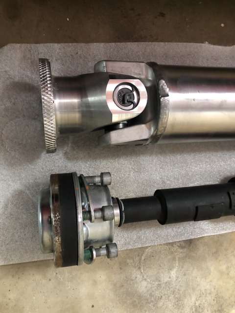

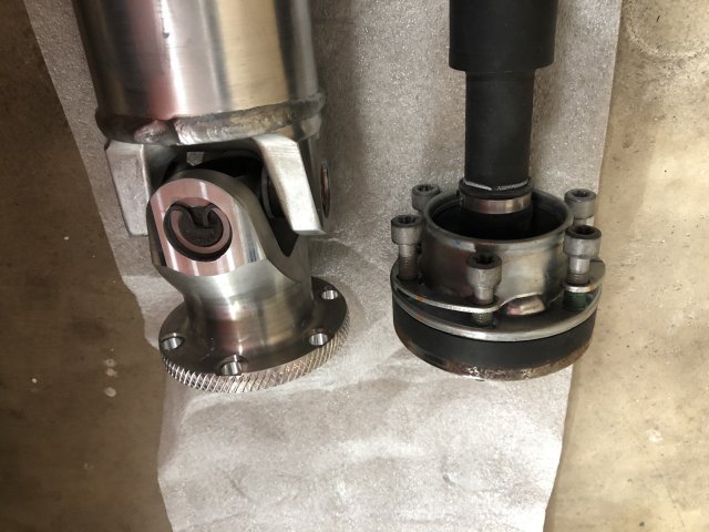

I have one, it’s still in the box, weighs 30+ lbs lol. I have faith in the Wiles DS, it really is built like a battleship, looks like it can take 5000 hp when sat next to a DSS CV type. Here it is compared to the stock CV type DS. But I do think about putting the hoop on, often.

my s&m is no where near 30lbs but if you're worried about 30lbs then I think you're priorities are wrong when that wiles sends your cat pole vaulting or becomes a buzz saw

Being I don't have one it looks like it weighs 10-15 lbs. The BMR I would guess a lot more

Wiles is awesome had it on my 15 no problems whatsoever, smooth like butter!
