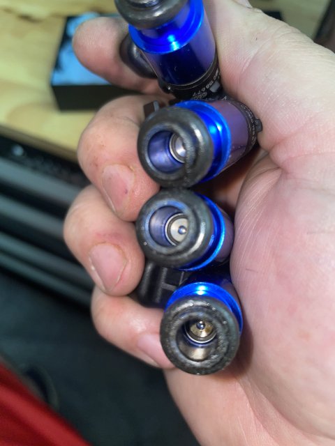

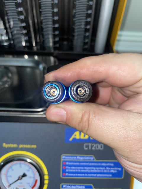

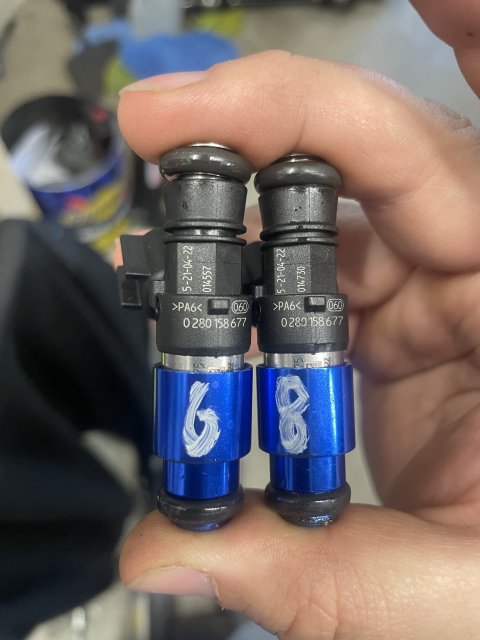

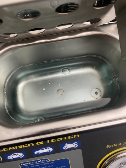

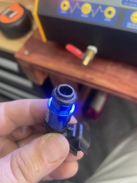

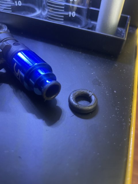

So when cleaning 6/8 as shown above I texted @Jon-MooredPerformanceLLC and verified that the orings are rated for e85. Well good news they are, bad news. What is the gunk on the injector? Well long story short it is probably the shit e85 from royal farms cut with poor gasoline. This article is a good reference. https://www.horsepowerinnovations.com/single-post/2018/02/03/mystery-of-the-black-goo-solved
93 cleans the tar, im putting the injectors through my machine and then they go back in.
Clean new fluid before cleaning. Will post the after results.

Were they seated all the way?.... looks like they were seeping past the O-rings?
Or too much Vaseline or lube when they were first put in? (that's what she said) :LOL:

None of the above, I have a fore fuel rail, there is only seat, nothing but seat.
Nothing seeped past the o-ring.
The article I linked explains a black tar substance that exists only on the intake side of the injector. It is due to a molecule in E85 that shouldn't be there if it was purchased from a good reputable source. I bought E85 from royal farms out of their flex pump. It was their recent blends at e70. However I have found an alternative source, a place near me has verified e85. In fact I was told tonight it tested at e92 so I'm about to load up tomorrow.

I read the story you had attached and the interesting thing about it is who wrote it, Eric Niefert. I have known him for over 20 years, lives 15 minutes from me. @jonx96 knows him also
Yes I was googling around yesterday sent it to him and told him this guy knows his stuff. Eric does carbs but is prolly the most knowledgeable person on e85 I know.
