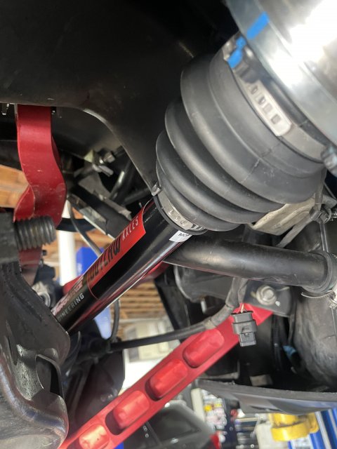

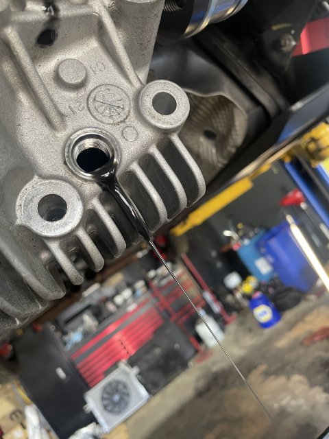

Was putting axles in, decided to service diff as well. Car feels way different in a good way. Drivers side axle was showing wear and tear.

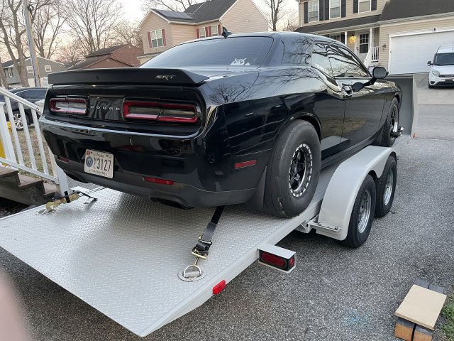

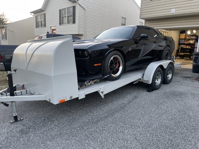

then to my delight learned the trailer would clear the driveway slope due to it being flat. I thinking I could get used to this bougie life!
View attachment 100894 View attachment 100895
View attachment 100896 View attachment 100897
Nice! Looking good on the trailer! Get used to your garage smelling like gear oil for a month lol
LOL, I learned that lesson already, I went to my friends shop and borrowed his lift.
8,756
7,682
I just brought my drain pan back inside been sitting in the yard for few weeks airing out after brake clean and degreaser lol. Worst smelling stuff ever. Changed it a few months ago and then topped it off again a little while back

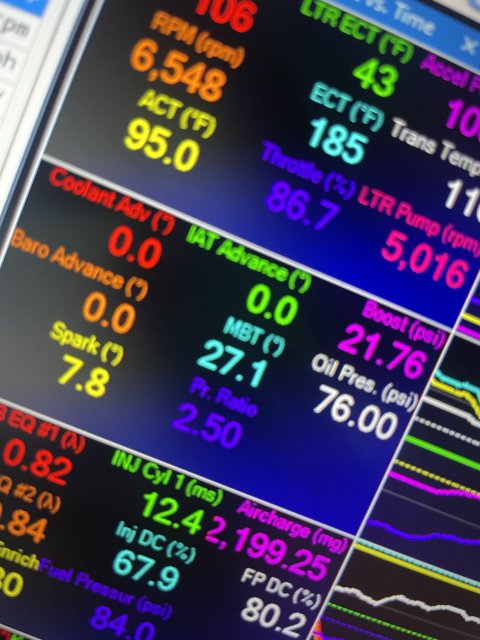

Not a problem broski. Start of pull: 62.6
End of pull: 87.8
Keep in mind air charge temps start to pull timing based on the following values in the tune:
You could move Part Throttle Ref IAT to 999 and it would never pull timing...
Didn’t you upgrade to triple pumps? Pump DC 89%, FP 79/80 psi, Or is that how it works on the control setup you’re using?
This is how it is, pump 1 is going hard but the computer don't know about 2/3
