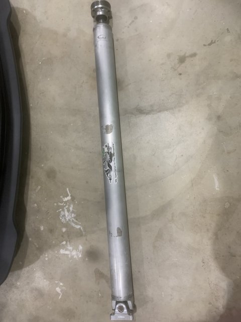

So does anyone want a gen 1 DSS aluminum driveshaft? $100 picked up, needs rebalance

Absolute junk anyone going to the shootout in Orlando? Swing by on your way and take it

I was trying to sell it for $300 but I’ve shipped a stock one before it’s like $120 to ship UPS

Deleted because it was a pic of my flipping it off, never again with DSS. Here, just laid it down. Comes with both mating plates and hardware

Would make a good spare to get someone home from the track if they break, but I would definitely get it rebalanced. For an A8 challenger
