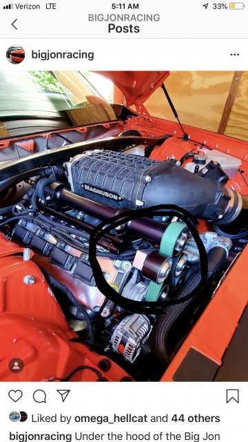

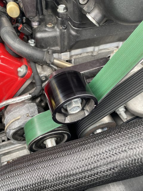

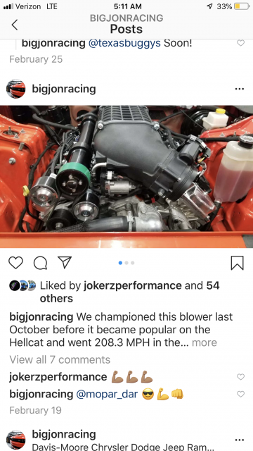

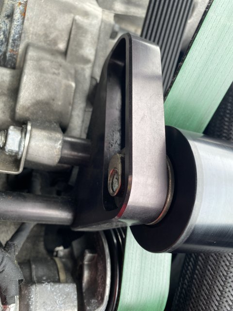

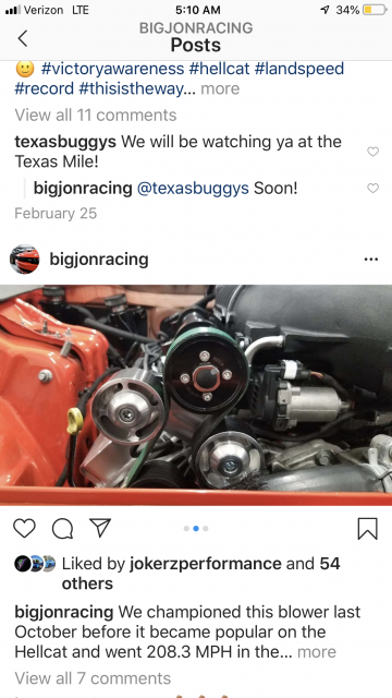

Has anyone seen a set up like this? My main attention is to the bracket that was made to hold the 2nd idler pulley in place on top. It helps with a lot more belt wrap as you can see. I was able to reach out to the 2 shops that have done this with there big builds running the magnuson. I’m finding out that with 1000hp plus to the wheels running the magnuson I’m not the only one experiencing a lot of belt slippage. The 2 shops will not be making anymore of these. I have made numerous calls to almost everyone including magnuson and no answer or help. This is turning out to be a big issue for Magnuson. They need to develop a bracket like this if they wanna keep up in the SC Mopar world. I did talk to Jokerz Performance and they are all in on making a bracket for me but they don’t have access to a Hellcat right now to get the correct dimensions. I did chat with bigjonracing and he had all the same belt issues I did till his shop made that billet bracket for him. C3D0CEB4-E8AE-426A-998F-09E18AE75A82.png 7C9027F3-D230-4A6D-A90C-0FE8BA9D9006.jpeg B660C26E-8F6A-495B-AFA7-800D51BB4E57.png

I will look into
What’s nice about the adjustment, is that when I change pulleys I can easily adjust belt tightness.
View attachment 17412 View attachment 17413
That might just work. I wish these shops could just give me the dimensions & blue print of it. Jokerz is ready to make them now and use my car for r&d.
