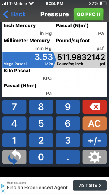

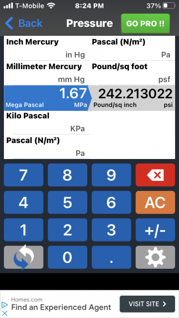

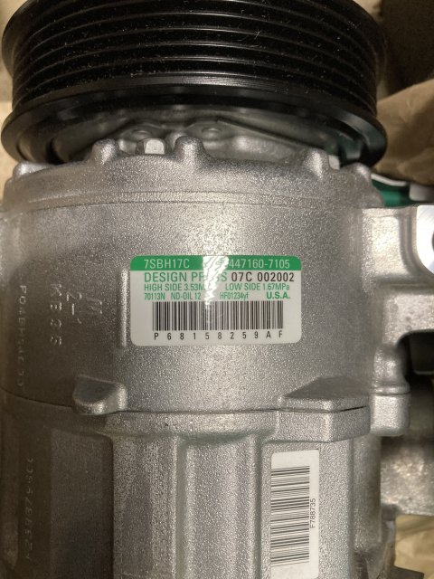

I received in today a spare Mopar AC compressor, look at pressures listed on the tag. That’s some high pressures!!

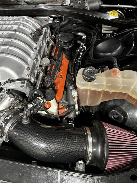

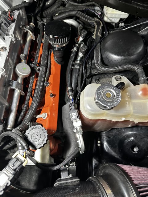

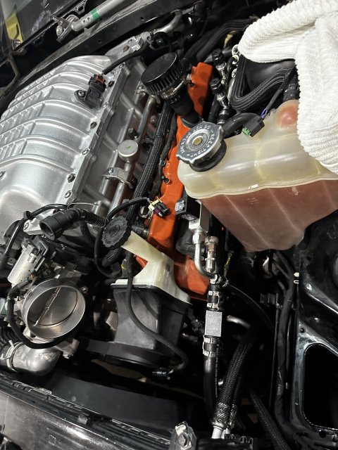

Jumped the gun and started ripping car apart before I had it evacuated. So it’s all installed and plumbed coolant wise, and now that 3 way salve is wired up should be fine to drive to shop. Also a good test to make sure nothing in the water side leaks. Hoping for AC lines to go smoothly

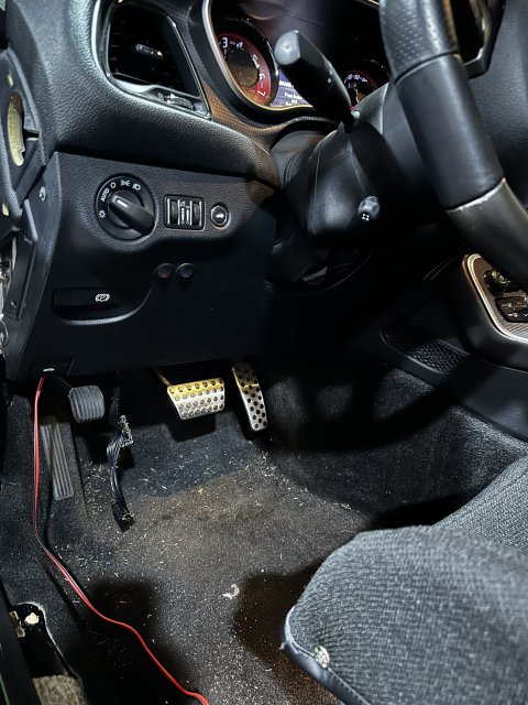

Thats only a manual thing, brake pull release lever. @Unholy707 car started life as a manual. Autos got the foot pedal.

What hose did you use on that Maddox coolant refill tool? Never put a hose on that end for evacuation.
Real stretchy 3/4 gates hose just taped, didn’t need to though, it didn’t spit out any fluid. That vent unscrews and you can screw in a fitting for a hose - might do that one day

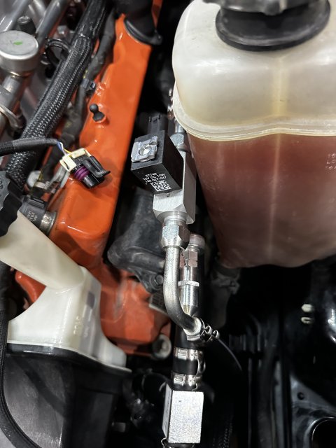

Done!!!

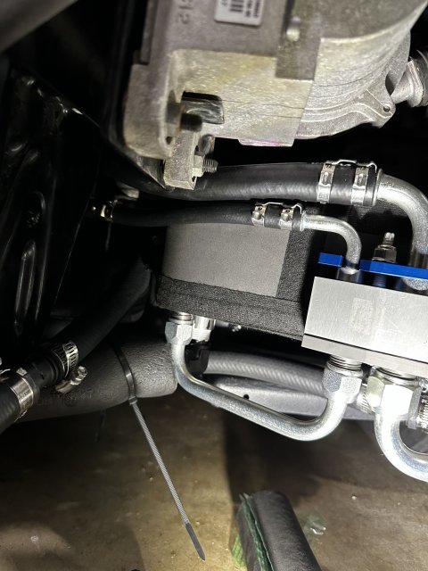

Ac lines are very straight forward and easy to do, took a few hours screwing around. Make sure you index everything with a marker, take it off, and then tighten the cnc fittings to the screw on hoses - makes life easier, and less chance of it coming loose. I used some left over pag oil to lubricator washers and o rings. The biggest feat is the plumbing for the 3 way valve. It’s a pain, but I can confirm it does keep the IATs and car just as cool as if it wasn’t inline when flowing through the heat exchanger. Big test is when I get it recharged 🤞🤞🤞🥶🥶

Also not a bad idea to mark your hose, cut, and crimp outside of the car - very easy to route the AC lines fully assembled

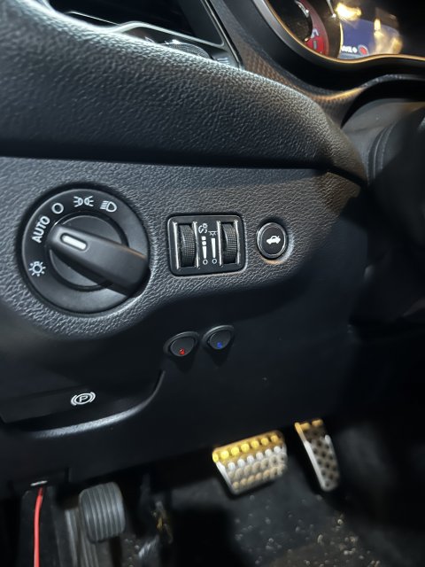

If you have a switch go bad let me know I bought a 10pk of different colors off amazon. I had 1 go bad on me 3 months into using it.
Thanks man! Will do! I actually want to get custom billet switches but my cars not nice enough for that, heck it has a plywood rear seat delete 😅🤣

I’m more worried about all the coolant lines than all the AC lines (no leaks!) if a hose go bad, besides having it evacuated, it’s small potato’s to change them out. I feel like I could plumb this all up again in a day, hours if not using the bypass. A lot of time was spent trying to figure out all the plumbing
