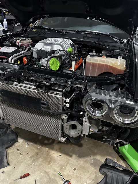

Getting ready. Found a bolt from my crash beam I thought I lost 4 years ago in the heat exchanger air duct lol. You can see the worm clamps where I’ve had this all apart before

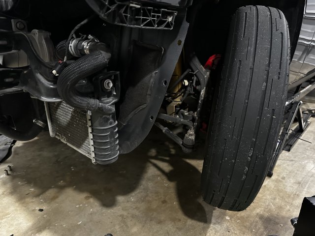

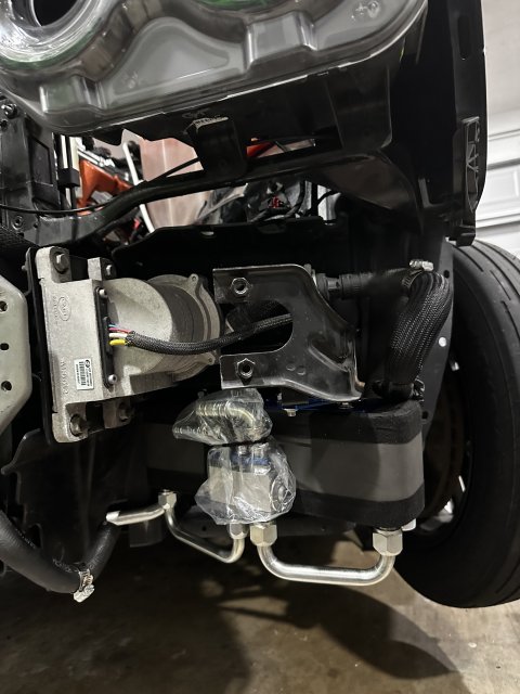

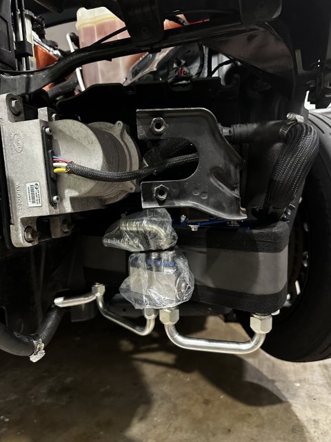

Getting mocked up. If you already drilled out the spot welds on your crash beam (like I did) I recommend pulling it completely, makes life a lot easier
