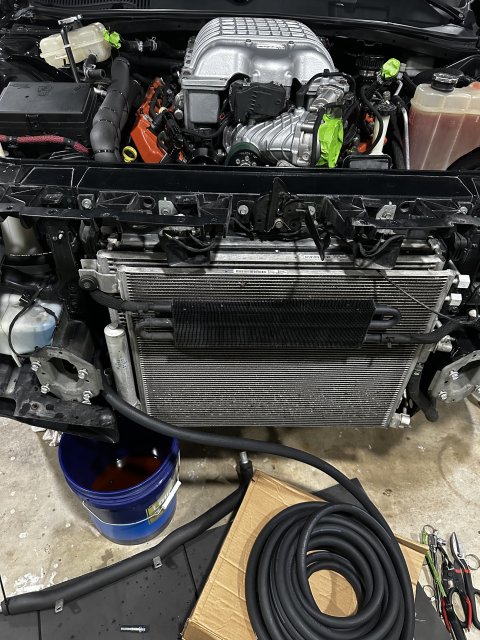

Hose came in. Decided heat exchanger is getting plugged off completely. If I change my mind, I’ll have plenty of hose left lol. Keeping the bugs on the condenser, adds character

Insulated good enough I’d say

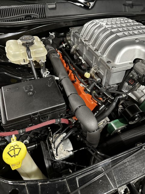

Are you guys wrapping (insulating) all of your lines (too hot line included) or just the bottom cold line going into the supercharger?
I insulated everything including the pump housing.
Oh wow. Do you know what the stuff is they use to cover the chillers/aux tanks? They’re rubber insulation in sheets? Looking for some of that

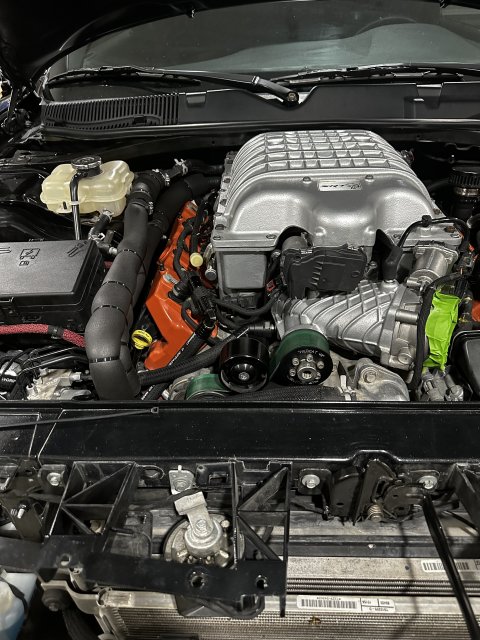

This just reminds me I need to re-do a bunch of mine.
One thing that Allpar didn't do was tuck it tight away from said alternator pulley. Oops. Lol
Really? Did the alternator pulley chew it up?

I also used the more expensive wrap which is smaller in diameter and bends/molds easy
3,858
9,173
McMaster Carr has adhesive backed foam insulation sheets, I used the 1/2” thick stuff
It self clearanced around the pulley. Plenty of room to the hard line. Probably an oversight as it may have been done with the cradle out of the car.
