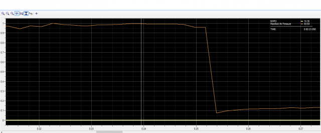

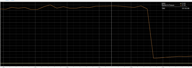

I hope I don't come off dumb with this post. I'm looking for help here and I am concerned since I bought the car used and don’t know it’s history
From what I understand from online research and watching Speedys youtube video is Boost is measured Manifold Air Pressure - Baro.
I only have a 2.85 pulley how am I making this much boost.
This would be 16.33psi DA was +800
This screenshot was -400 da but still 17.61psi on only a 2.85

for hp tuners i start log with the key in run to get the baro
1 MAP (kpa) = 0.145038 psi
then subtract the baro
looks like your map is already in psi

Yes map is already in psi.
I did not start the log with the key in run. Do you think that would make that much difference?
Baro seems to be about right.

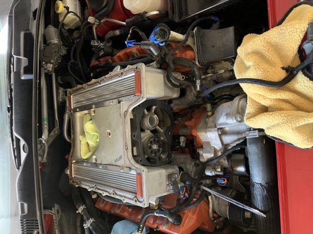

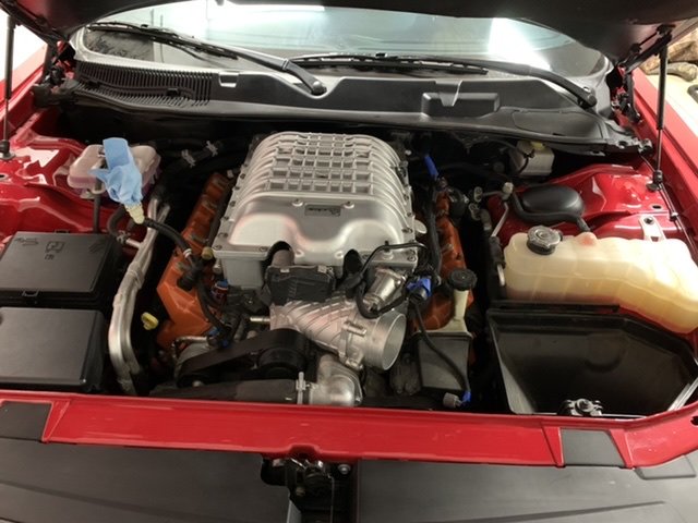

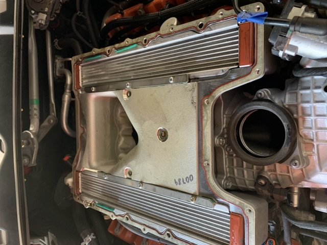

I wish I would have paid more attention when I pulled it apart over winter. Not that I’m aware of. But the cars used so maybe it was at some point. At first I was worried about a lower but i don’t believe that was it. I was talking to the wife about it this morning and said maybe it’s ported. I guess what would be the best way for me to tell if it is ported ?

5FC3BC2B-ACEC-41B3-953A-BD87E9790DE1.jpeg 7DFC87E5-9818-46B9-B32B-62F0EBE920C4.jpeg 5A68A0DD-BFDB-4A54-823A-22FCF2F47D47.jpeg

I took those pictures but that prolly doesn’t help much.
I would say looks stock.
you would know, much smoother like this
https://www.dusterhofftuning.com/products/jokerz-hellcat-supercharger-porting-service
