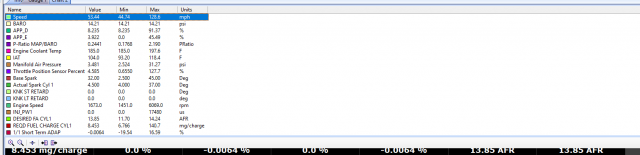

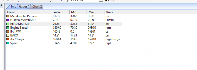

That's probably right in the air you're describing. My 2.72 will make almost 18psi in good air.
However, I keep saying to not look just at the "boost" but the actual aircharge. What's it say? That's the real measure of how much air is going in to the cylinder and what all the tuning is based on. To cross check "boost" you can also look at PRatio. 2.17 is around 17psi.
