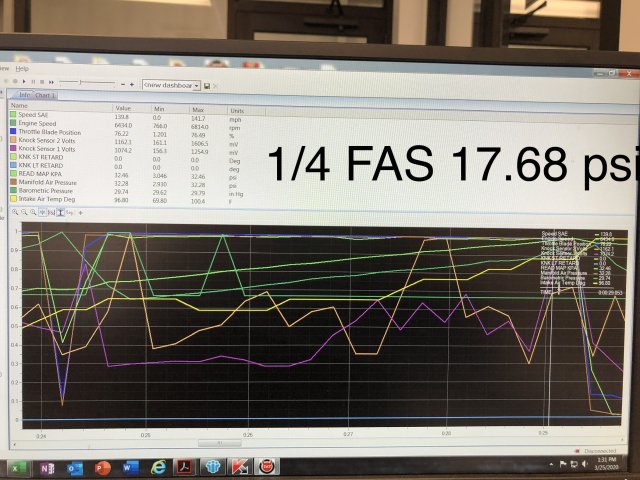

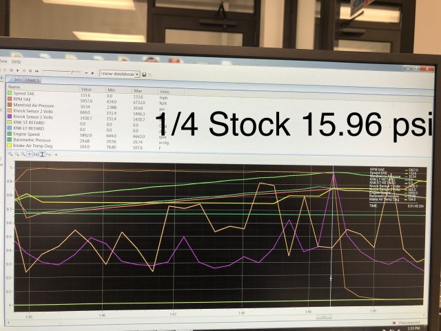

I hope I don't come off dumb with this post. I'm looking for help here and I am concerned since I bought the car used and don’t know it’s history
From what I understand from online research and watching Speedys youtube video is Boost is measured Manifold Air Pressure - Baro.
I only have a 2.85 pulley how am I making this much boost.
This would be 16.33psi DA was +800
This screenshot was -400 da but still 17.61psi on only a 2.85
When I do the math from above pressures I get 16.33 and 17.08 psi, that totally in reason with a 2.85, no belt slip with a tight blower in good air. That’s right where my original 2016 blower was.

I’ll have to look at that log again maybe that wasn’t the highest point for boost. I could have swore I got those numbers above. But who knows. When I get home I’ll double check everything. DA is around 300 right now so it’ll be good weather for a test. You are making me feel better of just having a good running car haha

Also, You need to look at baro and manifold pressure at the same time frame not just peaks as baro changes a bit as you drive around
Here I have attached 2 logs the first was before we ended up pulling timing the second is after we pulled timing
You will also notice I hit 87% injector duty cycle. Making this extra boost may be putting me in an unsafe spot.
