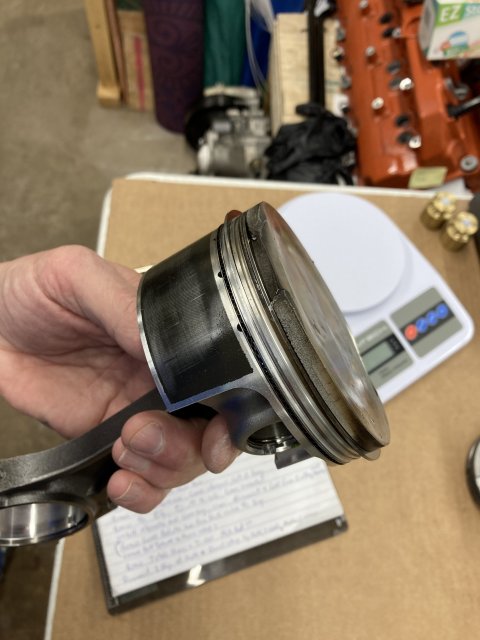

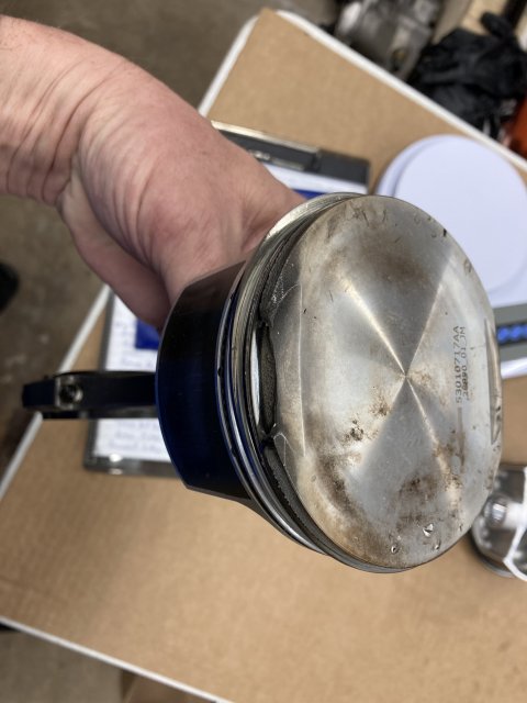

My number 7, typical failure, piston popped at thinnest point under a valve relief. A few theories, one is the corner cylinders run the leanest causing them to run hottest which leads to ring butting of the tightly gapped stock upper ring and pops the weakest part of the piston out exposing the ring to even more direct heat, the rings start to delaminate and leak more causing even more heat and expansion until the piston locks up at TDC on turnaround of the exhaust stroke and the bottom of the piston gets torn off and makes its last trip down the bore and out the bottom as on the next up stroke snaps the rod in half and makes a window to the world with the wrist pin like a shot gun slug.

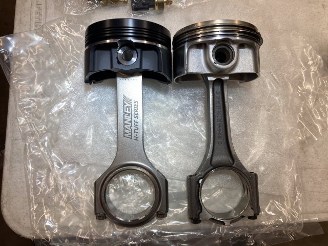

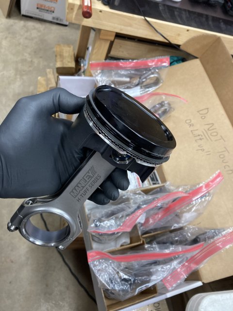

Replaced with these, .330” of meat between the fire storm and the ring, hard anodized top and ring lands and pin bores, PTFE coated bottoms and skirts. .250 wall H13 DLC pins with very close pin boss spacing on the piston keep crown flex to a minimum. Connected by a 4340 Manley H-Tuff rod on King Coated bearings. Top ring gap .026” verse stock .014-.018” which I think is the killer of these engines. Probably why a colder 180 Tstat helps and hot IAT’s and ambient temps doesn’t. Hoping this lasts a bit longer, someday see a bit of spray too possibly.

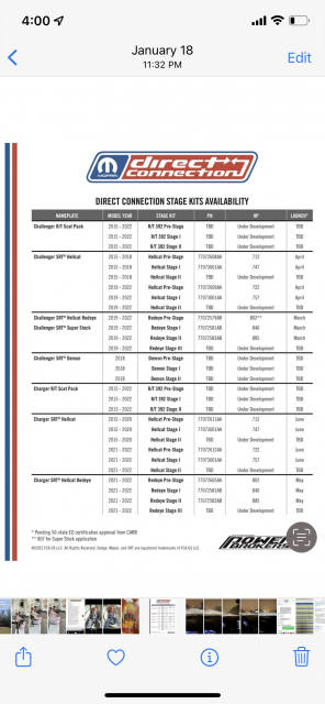

The Direct Connection parts kind of align with this as well. You'll notice there is no stage 2 for the Hellcat like there is a RE.
I keep hoping Dodge will release one more upgrade to this platform as a send off and I can pick one up. It's the reason I didn't go full built motor when mine broke and opted for a documented Mopar crate engine. I figured selling the car on others would feel better about that than some built motor I chose. I'd also been there done that with the full build on the old car and just didn't wanna get in to all that again. It's worked out well so far.
The stage 1 on the hellcat is the same. Pulley and tune on redeye and hellcats. The hellcat 94C1D31B-04B2-4D34-BBEC-AF0D4AA0FB4C.png wont get the high octane option probably because it runs a single fuel pump and smaller injectors compared to the redeye dual fuel pumps and demon injectors. But stage 2 is in development
