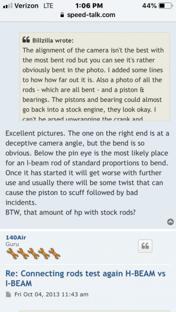

After inspecting piston and rod assemblies speedy sent me here is a brief of my deduction on what’s happening
Both assemblies speedy sent me bent in the pin area, parallel to the pin, both in the same direction. It appears the rods where not centered in the piston, both bent side towards front of engine down as if rods where offset towards the back of the engine. G force from launch or some form of thrust load from something? Block deformation??
The narrowing taper at the top of the rods is not helping matters either, it appears to be the weakest area of the rod especially at TDC where any offset in pin centering flexes that half the width of the pin bearing area some bright person put there to save weight, really?? And all this load is Increased tremendously before TDC if timing becomes a hair to advanced the load at TDC becomes extreme for the rod to toggle the piston over, it’s like the lock up in an injection molding machine toggle mechanism, it’s immense. When did the recent Redeye toss a rod? During a burn out, pinging off the rev limiter. What happens here when this happens? Same thing that happens when tires grab in a burn out, massive torque spikes in the driveline, what’s still trying to spin the driveline? The force on top of the pistons, what do the pistons see? Not even constantly building pressure of combustion expansion they see a jack hammer on top of them. If pressure is dead center on the rod it can take much more then if it’s off center, piston cocks and rod bends off to the side. What will a powder forged road then do? Break right under the pin boss and Splinter down the weak center like was pictured of that Redeye rod. I think it’s why autos fail more then manuals as the shock loading of the hard and shifting auto especially if tuned aggressively is trying to stop the pistons movement in very hard spikes. Add this one to the mix, timing. When is there the most advance? In the highest rpm. Say engine is turning 6500 rpm and timing is at max advance but something changes that rpm to a much lower number quicker then the pcm can pull the timing back. Lots of advance at a lower rpm and it would only take milliseconds (a few sparks only) for lots of super high cylinder pressure occur to bend one or many or all rods and the weakest one loss. But I know, why cylinder 2 and 7 so often? They are on the outer edges of the block which have the least amount of support in many areas, from crank journals to cylinder sleeve support. Metal starts to deform under pressure more then one can imagine. 20,000 lbs is allot of load on a piston top supported by a area 3/4” wide at best ( the pin in the rod tip) now that’s design pressure. What kind of pressure is going on under more boost (ie more cylinder pressure) then design to begin with and now add pre ignition into the equation. It’s no wonder they fail. I think if a few of my burn outs over the weekend at the track and how violent the grab was when they would stick, I changed my technique to finishing a burn out by pushing in the clutch not feathering it out until it grabbed, all that came to mind was bending a rod. Them came Monday, yesterday, and I inspected the assemblies Speedy sent me, God I feel blessed that in 19 runs I didn’t break a rod too.
What will I be doing this winter? Upgrading my pistons and rods and studding the crank caps and head fasteners. Big question at the moment is use a I beam rod like stock or an H beam rod??? Seeing this failure mode makes me lean towards a stout I beam rod with a wide top pin boss with full floating best pins money can buy wrist pins. And spray them with as much oil as possible to cool the piston bottoms.

These the 2 most relevant to our Hellcat engine failure points clips from the lengthy (but good read) article on I beam vs H beam rods. This is exactly what I’m seeing in the rods Speedy sent me. I think a robust I beam rod would suit us best. We’re not spinning 8k+ rpm so light weight rod really isn’t as important as a higher strength possibly heavier rod is, I’d prefer a stronger, heavier rod for my engines intentions at least. I never have wished for winter to arrive quicker but I do now. I hope I don’t have to say what the “bad incidents” are the OP was referring too :(
