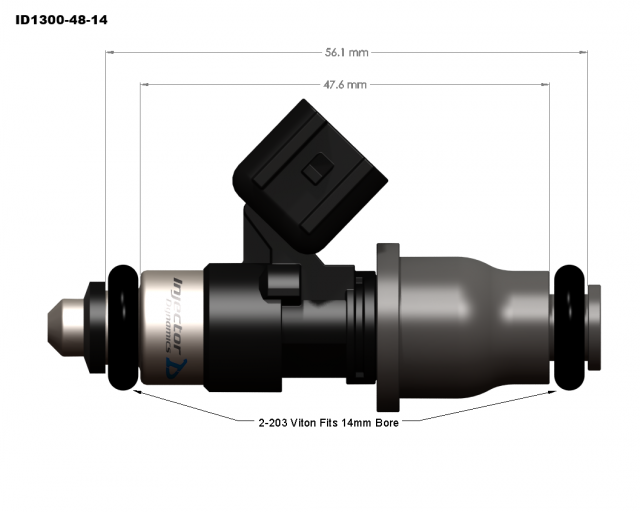

Interesting equation from a cost standpoint. The E85/426 with a 3.8 Whipple combination is starting to require injectors that are not going work with pump gas to drive on the street. At some point the injectors needed for 1500hp ethanol motors are too big for pump gas. Does anybody have that combination running on the street with pump gas using 2150 or bigger injectors? Also…. Interesting side on injectors. Everybody is looking at ID and FIC injectors. You all know that they are Bosch injectors with pixie dust sprinkled to double the price. Right? We use the same Bosch injectors with the same flow match pixie dust from FIVE0 Motorsport Injectors in California. 2200cc at 45 psi - 2550cc at 58 psi. Do the math. A set of eight is $1400. View attachment 133212 View attachment 133213 View attachment 133214
My personal car has been rolling on around on the street on 93 pump and 2150s. More as just a test. So far so good. @vortecd went for an hour ride with me

If I were to run pump gas more often I would not want to be on the 2150s full time. But yes with the right came and bigger displacement engine you can really push some hp through 93 octane
ID 1300s would be fine for me if I was never on e85.

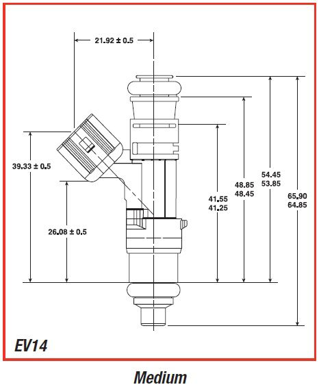

Marc,
You sold me, what model number are the 2200 cc injectors? The photo you posted? I get screwed up on the terminals and needed voltage for the correct injectors (I don't want to order the wrong ones).
I have reviewed these injectors: https://www.fiveomotorsport.com/fuel-injectors/2200-bosch-64mm-usa-asian-fit/#additional
There is no published data on them for the Hellcat so using them with a stock PCM will be iffy. There is a chart as an image for that injector but it may not extrapolate into anything useful.

In regards to the original injector from bosch these are know as #210 injectors. 02801588XX is the prefix for a few different variants. Truth be told all of them have one thing in common, not compatible with Q16. MBTE is present in these fuels.

I was using them with the Whipple DragPak 3.0 that you have and the Holley Dominator. Their rails also. No mods necessary there. Just out of curiosity I will ask Adam just to make sure if he’s using the FIVE0 injectors on all the injector upgrades he does using the OE computers. He apparently likes tuning them. Watching what he’s doing with my tuning, he’s never complained that they ever present any difficulties. In fact he has commented on how reliable they are. Of coarse every tuner does stuff differently.

IDs flow more than an FIC of the same cc, at least that’s how it was. Feel free to comment if that’s been proven differently now
