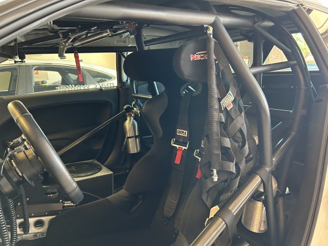

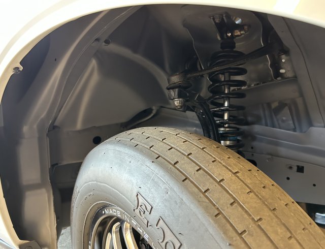

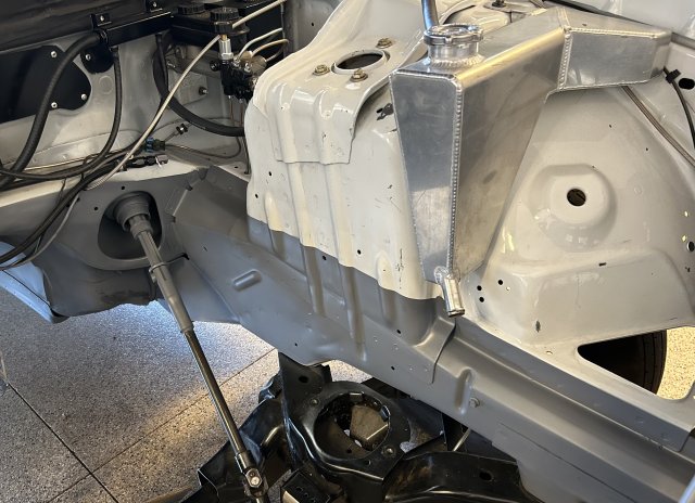

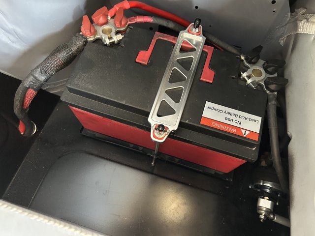

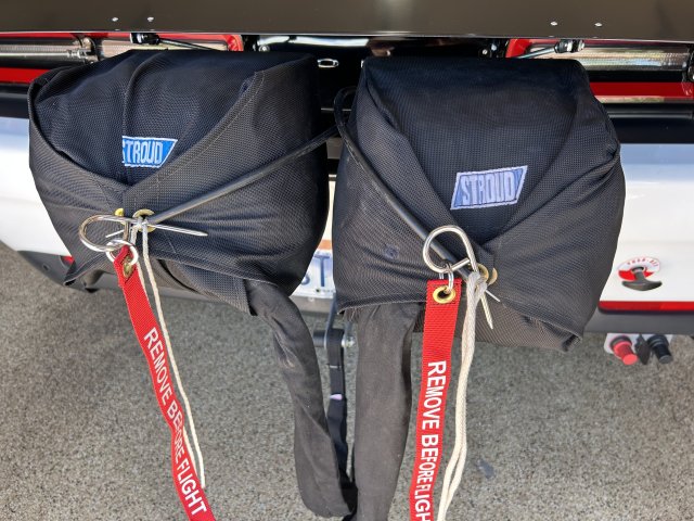

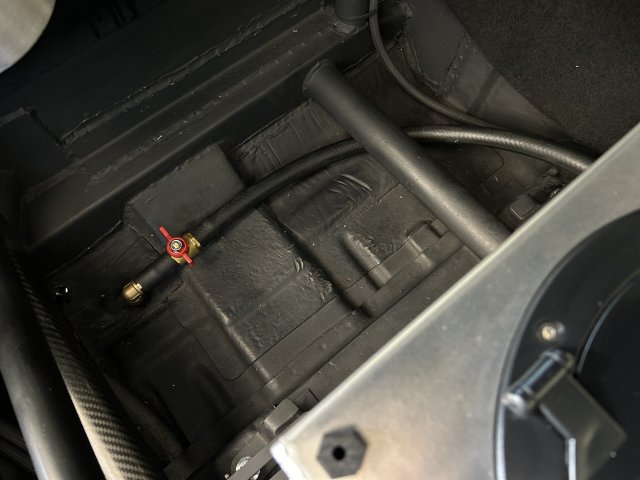

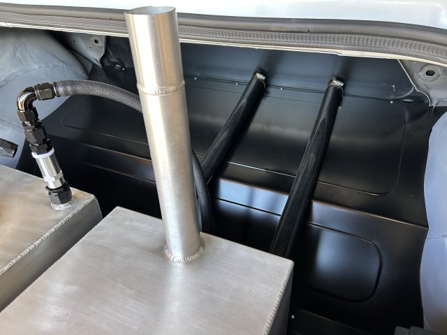

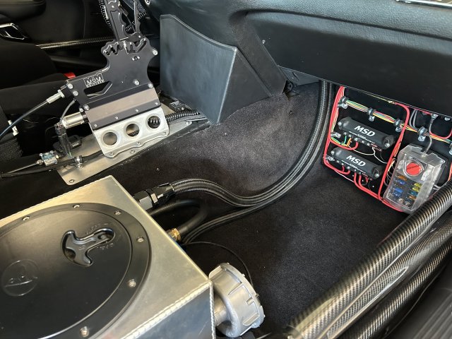

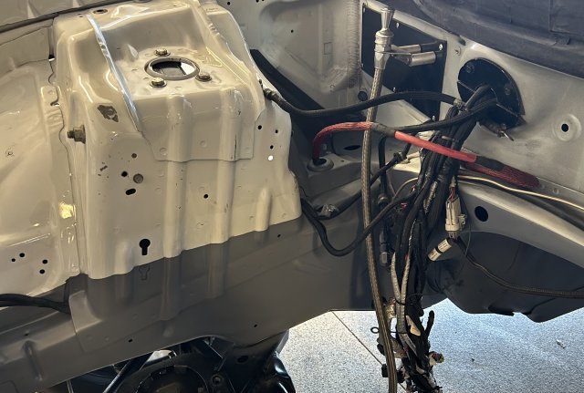

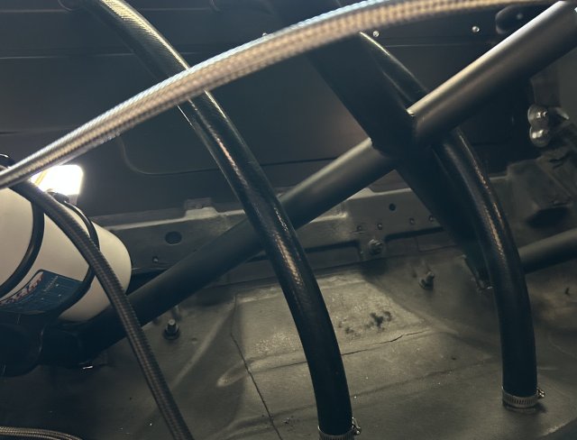

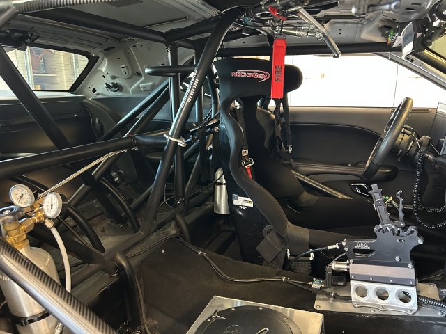

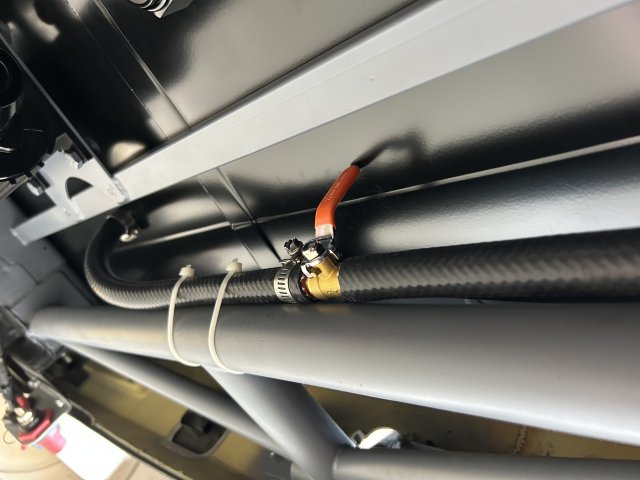

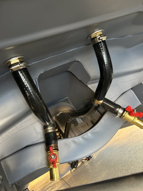

Uh.. just a bunch of necessary detail and fabrication work getting done by me before dropping the new motor. Puke tank plumbing. Second chute cable. Detailing the engine compartment and wheel wells with the gray primer used underneath. I just got done designing and fabricating a way to connect the 5th and 6th point placement of my new harness. The NHRA in their wisdom 🙄 has decided that cars running 7.99 now need to change to a 6 point harness. My current harness cert expires tomorrow anyway so 🫤
