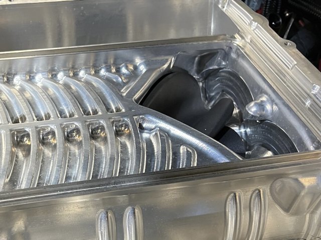

How to tell if the unit is billet? Is there a serial number that indicates that it is billet or can it be determined visually?

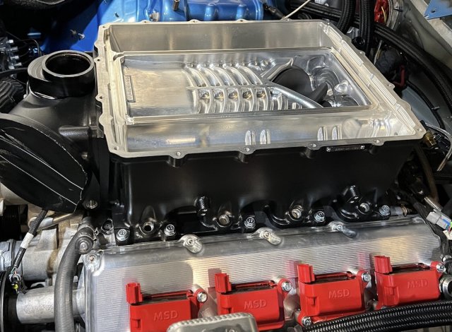

Pull the lid off and you can see the CNC tool marks here and there. The inside has that jewelry appearance compared to the cast look. Here’s my Billet inside…. IMG_0317.jpeg IMG_0318.jpeg

Pull the lid off and you can see the CNC tool marks here and there. The inside has that jewelry appearance compared to the cast look. Here’s my Billet inside…. View attachment 133217 View attachment 133218
